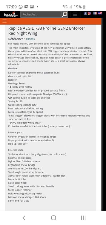

Hi guys, I'm looking to get back into airsofting and need a new gun. Used to have a TM M4 but gearbox has been completely destroyed and to repair it to working with mosfet etc. Is out of my price range.
I have been doing some research and found this gun, I was wondering if it's as good as it looks. These are the specs I've found online (attached).
Regarding upgrading, what would be suggested? I'd like is to shoot 360-380fps.
I heard the brand werent the best a few years ago but have seriously up the game recently and it's been recommended on a few websites.
Thanks in advanced!
