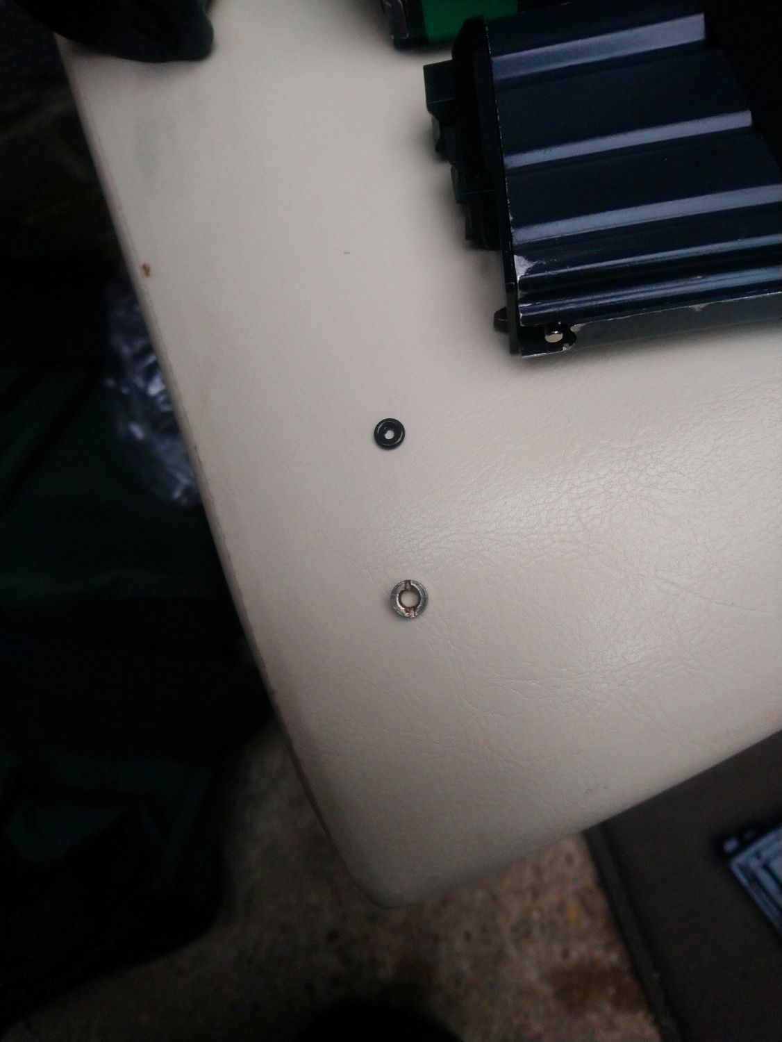

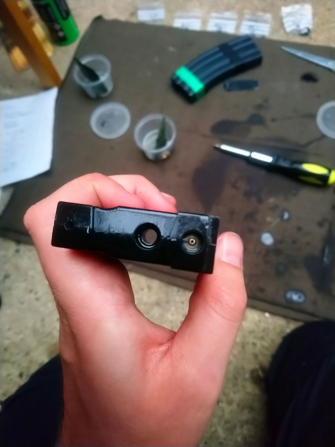

So I was replacing O Rings and doing some general maintenence on my WE M4 Mags and, despite all the warnings, I've over tightened a Full Valve and the head of the Valve has come off (See attached images).
So, two questions... How on earth do I get that out? It's threaded on, so needle nose pliers and rotate it back out is my best suggestion?

You can’t use the middle to loosen it, it will just rotate. Can you take the base of the mag off and get at the other side of the valve, get it out buy turning it “in”
And yes, threads are the same
Based on my experience with RC cars you have a couple of options:
1. if you can take the base plate off the mag you might be able to get a pair of pliers on it from the back or dremel a slot in the back edge for a flat driver and get it out that way.
2. screw extractors can sometimes work https://www.toolstation.com/damaged-screw-remover-set/p38732? store=EE&utm_source=googleshopping&utm_medium=feed&utm_campaign=googleshoppingfeed&gclid=CjwKCAjwqJ_1BRBZEiwAv73uwN1a3umhSN77GE-0Vu6GavvjzdvJhYGoDzDHnKC4EByR2G3p1210cxoCnS0QAvD_BwE You need to be careful to avoid damaging the mag.
3. As a last resort drill out the centre of the valve and then araldite a sacrificial Alan key in the drill hole. After the glue dries (16 hrs) just unscrew the Alan key. Again care needs to be taken with the drilling (so you don’t damage the mag) and the gluing (so you only glue the Alan key to the broken valve and don’t end up gluing the broken valve in).
Thanks for the response guys; I can get the magazine apart and access from the inside, so I'll give that a go first and foremost!
Good news!
Managed to access it from the inside with the finest flathead screwdriver I could find and rotate it back out the way it came in without damaging any threads or anything. Success! Thanks for the suggestions again guys, appreciated no end!
