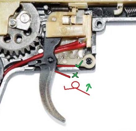

I would check the trigger spring first, if it was particularly fiddly and kept wanting to pop out you may have put the shell back together with the long portion of the spring which pushes against the gear box shell actually resting outside the shell (see pic... the position with the X next to it). Naturally it wants to pop out and rest in an un-tensioned position outside the shell.
The long part of the spring needs to be pushed over the wall and pressed into the shell behind the plastic safety arm (see pic.. the position with the tick next to it).
Sometimes you can actually use the safety arm to help keep the spring in place by keeping it in the auto position covering the springs long portion.
Auto works because in this mode it makes use of 2 springs to reset the trigger: the trigger spring and the switch block spring - however in semi the switch block is flicked out of the channel by the cut off lever and then waits for the reset of the trigger spring to return to its starting position.
Sometimes you can check to see if this is the issue with the gun fully assembled, peak through the hole in the receiver that the trigger protrudes from, some times you can see the gearbox and that piece of the spring sticking out where it shouldn't be.
