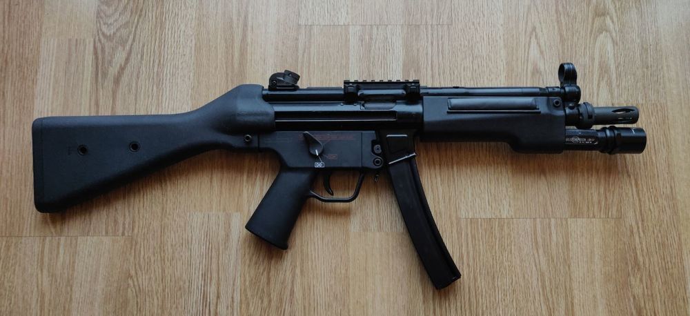

On 30/04/2021 at 11:04, Clutch said:
I just installed the V2 upgrade kit and now I want to putt more good things into my MP5. Anyone having experience with the T.N.T. hop up chambers?
@Clutch
Yes, I upgraded an A2, including with the T-N.T. APS-X System T-HOP - that one's gonna increase the fps, if you need that to happen.
Here's the list of mods on it:
-          T-N.T. APS-X System T-HOP (220mm) [87 USD]
-          Crusader Enhanced Feeding Ramp [7  GBP]
-          Angry Gun 120% Recoil Spring Guide [11 GBP]
-          Crusader Steel Hammer [22 USD]
-          Guarder MP5 Tactical Handguard [59 GBP]
---------- Surefire 6P ORIGINAL [60 USD]
---------- Cree Led Forend light [25 GBP]
-          Low Profile Scope mount [13 GBP]
-          Navy Flash Hider [45 EUR]
-          Bow Master CNC Ai Magazine Follower [10 USD]
-          Various magazine valves tried and tested (not sure which one was chosen in the end)
I also upgraded the bolt carrier sets (I tried several configs) with a shiny Bolt Cover Assembly. It's always nice on its own, and it's cool to see the bolt lock in place on the side when the mag runs empty, because of the mag followers installed (and those were actually quite difficult to install; I broke the seal of 2 mags doing that, and couldn't repair them).
The carriers I've got:
1)      Standard carrier and nozzle
2)      Crusader Steel Bolt Carrier with Enhanced Cylinder Set [60 GBP] and Ready Fighter Reinforced Loading Nozzle [12 USD]
3)      Standard carrier with restricted gas exit hole nozzle (for lower fps / different gas like CO2 - via a special mag) [X]
4)      Zinc bolt carrier [25 GBP] with transparent reinforced loading nozzle [15 USD]

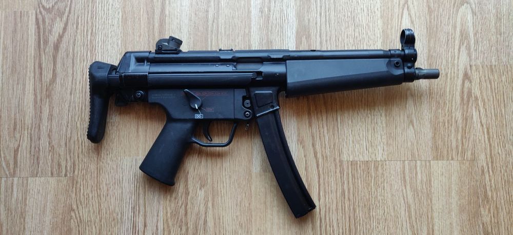

In the pics the other one is an A3, also from VFC - sadly:wacko: this all has to go as I'm leaving the UK. . and I've placed ads in the classifields.
Guess I'll live with these pics afterwards!
