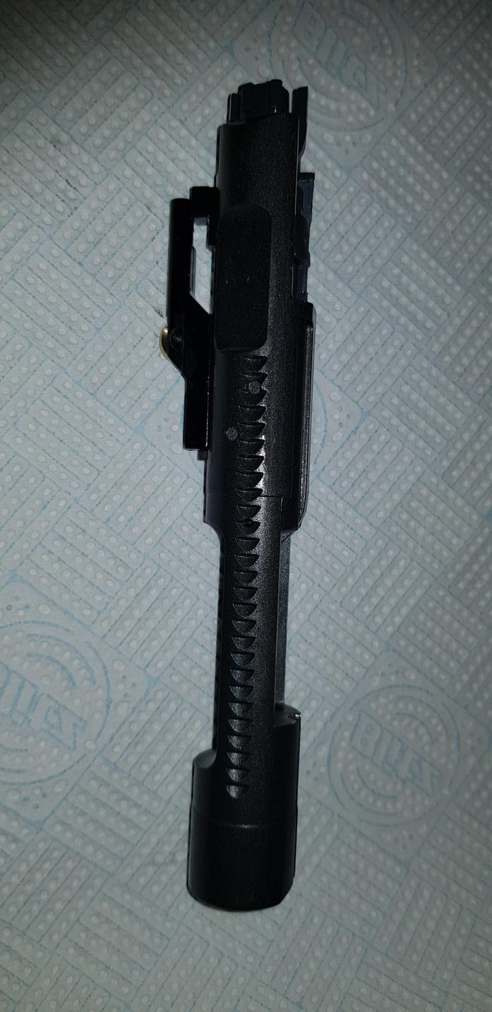

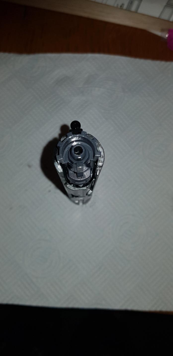

Ok folk put two other mags through the gun from inside the house still kicking bb's out on auto but only after 2-3 bursts. Some pictures of the bolt

Nozzle looks completely fine, to confirm, this only happens on full auto? Were you using red gas indoors? Also BBs are coming out of the barrel at the same time as them being kicked out the ejection port?

Hard to see but looking at the first photo at full res it does look like there are a few dings in the top part of the hood where the fake lock lugs are.
Don't think it will be the cause and shouldn't affect performance but keep an eye on that area to make sure it doesn't get worse.
