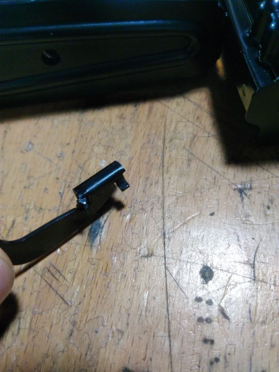

Me gun is in bits currently getting a refinish, but i'm meaning where the spring hooks over the tab here:

The spring is nested in the left side of the trigger unit, it shouldnt fall out unless you remove the whole thing.
One end sits on the slide lock holds it down, so i'm assuming if its slipped off then the catch is jumping up when firing.

Found that spring, god its miniscule
All fixed and can now actually hop .3s.  Thanks for the help.  Learnt a lot about the platform.
Yeah its just the very tip sits on the slide catch to hold it down.
Thank god it doesnt go walkies as long as you leave the trigger unit in.
