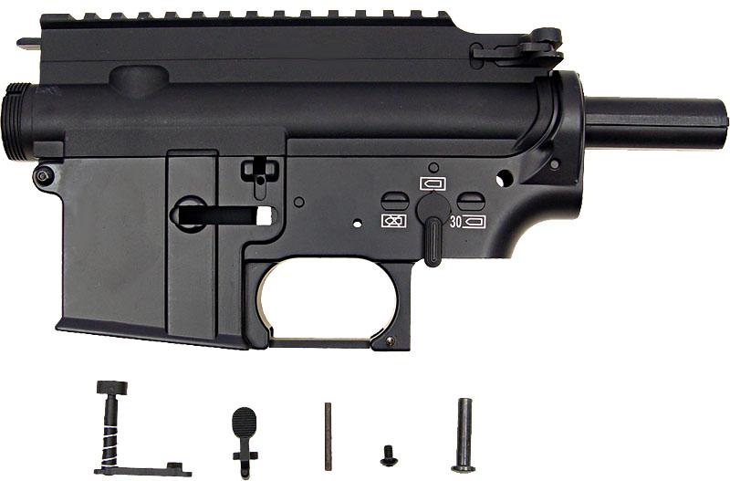

Just in case you aren't aware, the 416 upper receiver isn't the same as that of a standard m4- the upper rail is raised slightly- that then sits flush with the fore-end's rail.
As a result if you put a 416 handguard on a normal m4 receiver there will be a 'step' up at the front to the handguard's top rail.
You can see how the rail is raised by the steep curve between the charging handle and start of the rail in the image below
It's not a big deal as such,  just a looks a little odd,
Quite a few 416 rails and receivers also have a notch where they attach to each other too so some won't fit an m4 upper receiver anyway (far right in this photo)
Sorry if you're already aware, just wouldn't want you to buy the rail and end up dissapointed etc.
I'd say your best bet would be to build a second m4/AR-15 upper set using a different rail- something else that's monolithic etc.- It won't be quite the same but there are a few that are similar in appearance
Here's a link to a 416 rail anyway
https://www.zerooneairsoft.com/product_info.php?products_id=8198
It's do-able, but the fire selector markings on the lower won't be right (if that bothers you).
You may also find it's actually cheaper and easier to buy something like this https://gunfire.pl/product-eng-1152216913-SA-H08-Carbine-Replica.html or this https://gunfire.pl/product-eng-1152212513-SA-H02-Assault-Rifle-Replica.html
