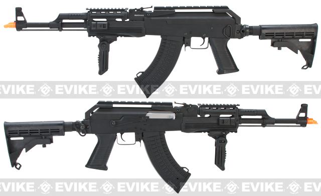

Jake Carter Posted October 6, 2017 Posted October 6, 2017 i have a cyma cm028c which fires 380 - 400 fps with 0.20G, if i use 0.30G will my fps go down to around 340 as my sites fps limit is 350
Hangtight Posted October 6, 2017 Posted October 6, 2017 That's not how it works. 350fps WITH 0.2g is the limit. Change the spring. End of, no arguments.
Supporters ImTriggerHappy Posted October 6, 2017 Supporters Posted October 6, 2017 2 minutes ago, Jake Carter said: It's an electric gun m8 Hahaha best answer ever hahaha
EDcase Posted October 6, 2017 Posted October 6, 2017 The electric motor pulls back the piston but still uses a spring to push the piston and fire. Look up some vids on how to change the spring in an AEG and you'll get the idea. (You can also cut a few coils from the spring but that can lead to problems if not done properly) Might be better to find a shop or gun tech to do it for you...
