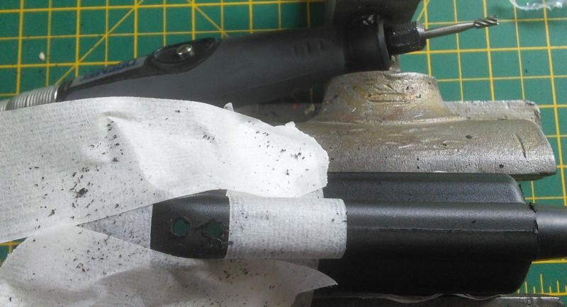

A bit of masking tape shows the area thats causing you problems...
http://img.photobucket.com/albums/v66/Glaive/Serpa%20mods/IMG_20140709_171338_zps9232cc8c.jpg
which along with some pilot holes and drilling gives you this...
http://img.photobucket.com/albums/v66/Glaive/Serpa%20mods/IMG_20140709_171850_zpsd47fc1cd.jpg
which you can open out to this...
http://img.photobucket.com/albums/v66/Glaive/Serpa%20mods/IMG_20140709_172639_zps08e2ddd7.jpg
this allows your square guard to enter the rounded holster.
