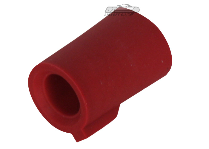

Supporters Rock-climby-Dave Posted June 6, 2012 Supporters Share Posted June 6, 2012 up the power and up the BB weight, possibly into ceramic or metal rounds. I've had a play with an SMK CO2 VSR platform - runs around £120 and at 650fps before upgrades it would be a good place to start. Id suggest that + the best 6.03 tightbore you can find + a hard hop rubber. It may even be worth looking into the R-hop mod. Be very careful at those power levels though, anything below a .3 will be impossible to aim, the BB lacks enough momentum after about 5m to push through the air, so whips around wildly - upping to a .43+ will mean any ricochets still carry very painful hits to a person. 400 feet isn't that far, theoretically I would like to see you putting every round into a coke can, certainly an A4 page at that range with the brief given. Link to comment Share on other sites More sharing options...
Reezo Posted June 6, 2012 Author Share Posted June 6, 2012 up the power and up the BB weight, possibly into ceramic or metal rounds. I've had a play with an SMK CO2 VSR platform - runs around £120 and at 650fps before upgrades it would be a good place to start. Id suggest that + the best 6.03 tightbore you can find + a hard hop rubber. It may even be worth looking into the R-hop mod. Be very careful at those power levels though, anything below a .3 will be impossible to aim, the BB lacks enough momentum after about 5m to push through the air, so whips around wildly - upping to a .43+ will mean any ricochets still carry very painful hits to a person. 400 feet isn't that far, theoretically I would like to see you putting every round into a coke can, certainly an A4 page at that range with the brief given. I agree. The main points of my upgrades are going to be: - an HPA/CO2, dual regulated, external air rig - an IR-hop in my 6.03 Prometheus TBB I might go IER-Hop but I would need to file the hop window on the barrel and I will try and see how the IR-Hop behaves, first. I'll be using something like 0.88g steel BBs and start increasing the PSI on the rig very slowly, session after session. My Tanaka M40A1 already has lots of upgrades, mostly steel parts hitting against steel parts, reinforced striker springs and unrestricted PCS/nozzle. The 29 round magazine is excellent for drilling the air rig in and holds gas like a tank, PSI wise (tested by other users as well). From here I'll see where it goes. If I can hit a soda can at 400ft, I am in the ballpark Most of the participants have NO idea about R-Hop and external air rigs, so anyone using normal buckings and BBs lighter than .43g is probably get raped by my setup - IF it works Once the technicalities are laid down and ready, it will be practice time. Lots of practice time. Link to comment Share on other sites More sharing options...
