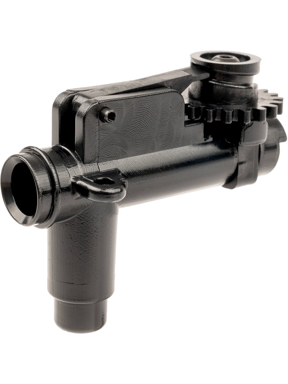

Zarrin Posted September 25 Posted September 25 Evening Don't suppose anyone has slapped one of these into your generally available brand AKs (CYMA, G&G, TM, E&L etc) Thinking about replacing the default cast G&G hop in my GKM. Worst case will just buy one and see for myself, but thought there might be some xp floating about - I can't be the only one fed up with the crappy little slide. https://www.patrolbase.co.uk/lct-rotary-hop-unit-for-ak-aeg?srsltid=AfmBOormEOVAtsd9Ni3W6kY6g8j776qtSpe6crPiKamhbHW4BqHma4wm
Hudson Posted September 25 Posted September 25 I've had the same thought as you, and decided to take the plunge. I installed it into one of the Raven AK74s which have a similar, if not directly copied design from the later CYMA AK models. It was a little tight compared to the lonex Hop unit I had in previously but it did fit and feed fine. I've yet to actually skirmish with it, so I can't tell you how it actually performs but it does at least fit and feed ok. Zarrin 1

The_Lord_Poncho Posted September 27 Posted September 27 Here's another one to throw into the mix.... https://www.patrolbase.co.uk/specna-arms-magnus-tm-tdc-rotary-chamber-for-ak-aegs Zarrin and Hudson 2
Austeyr Posted September 27 Posted September 27 58 minutes ago, The_Lord_Poncho said: Here's another one to throw into the mix.... https://www.patrolbase.co.uk/specna-arms-magnus-tm-tdc-rotary-chamber-for-ak-aegs That looks better than the LCT one 👀
Zarrin Posted September 28 Author Posted September 28 (edited) Oh nice - do Specnas come with those as stock then? I wonder what the point of that flat top cover piece over the barrel entrance is, looks optional either way Edited September 28 by Zarrin
Austeyr Posted September 28 Posted September 28 49 minutes ago, Zarrin said: I wonder what the point of that flat top cover piece over the barrel entrance is Most likely a spacer to make sure the hop unit is seated against the gearbox, replacing the L shaped piece (That did the same job, a spacer for the hop unit) that has a habit of falling out as soon as you look at the replica funny
Hudson Posted September 28 Posted September 28 Well I had a bit of a shit day all in all, but one of the few decent bits was getting to test the new hop in the AK. It works, but perhaps *too* well if anything! I had to have it set to Minimum hop, with a 4uantum and using 0.32s to not get significant over-hop. Otherwise it seemed absolutely fine however, and worth the fairly low price. Zarrin and The_Lord_Poncho 2
Zarrin Posted September 29 Author Posted September 29 12 hours ago, Hudson said: Well I had a bit of a shit day all in all, but one of the few decent bits was getting to test the new hop in the AK. It works, but perhaps *too* well if anything! I had to have it set to Minimum hop, with a 4uantum and using 0.32s to not get significant over-hop. Otherwise it seemed absolutely fine however, and worth the fairly low price. Good to know! I mean I find that issue quite common when using tall nubs like an omega or similar paired with Macarons and other off the shelf flat hop type buckings. sometimes you have to sand a mil or so off the lever arm to ensure less protrusion at the lowest setting.
Hudson Posted September 30 Posted September 30 I thought a photo would be of use to those interested. A bit more awkward to adjust than the normal hop unit however. Zarrin and The_Lord_Poncho 2

Zarrin Posted October 1 Author Posted October 1 19 hours ago, Hudson said: I thought a photo would be of use to those interested. A bit more awkward to adjust than the normal hop unit however. Ah I see, because most AEG AKs only allow a couple of inches of movement on the charging handle - the old slide allowed adjustment to be accessible from the front of the chamber, the dial does not. Interesting. If that is the case, we're talking, Pros: finer adjustments and holds position while firing. Cons: might need a flat head screwdriver (or dust cover off) to adjust.
Hudson Posted October 1 Posted October 1 3 hours ago, The_Lord_Poncho said: Can it be adjusted still via the dust cover/ejection port, or do you need to lift the top cover? Without tools, then I think you still can, providing you lack sausage fingers, but it's definitely more of a challenge. I've been using a small screwdriver just to make it easier, as Zarrin says. The_Lord_Poncho 1
