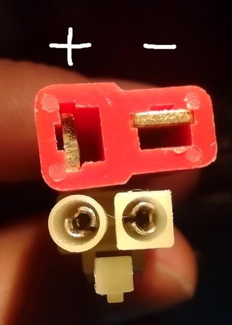

EDcase Posted September 10 Posted September 10 This is my home-made adaptor so I know its the right way around RostokMcSpoons and ButcherBill 1 1
RostokMcSpoons Posted September 10 Author Posted September 10 20 minutes ago, Austeyr said: Could you not make a deans to tamiya converter in case you end up in the same situation again in the future? lol Well I suppose I could But often cabling space is at a bit of a premium (and it is a bit in this case) so I prefer to make it all 'go native' 8 minutes ago, EDcase said: This is my home-made adaptor so I know its the right way around 18 minutes ago, Galvatron said: In terms of the terminals on the mini-Tamiya connector, the circle would be the red cable and the square would be the black cable so if you were converting it to Deans, the cable from the circle terminal of the mini-Tamiya would be soldered on to the horizontal part of the Deans "T" whereas your square terminal cable from the mini-Tamiya would be soldered on to the vertical part of the Deans "T". Cheers guys - thanks 👍 Austeyr 1
EDcase Posted September 10 Posted September 10 (edited) Using an adaptor in game is pointless because you're losing the benefit of the better contact from the Deans connector. I only use the adaptor to test a new pew before soldering on a Deans. 28 minutes ago, Galvatron said: In terms of the terminals on the mini-Tamiya connector, the circle would be the red cable and the square would be the black cable so if you were converting it to Deans, the cable from the circle terminal of the mini-Tamiya would be soldered on to the horizontal part of the Deans "T" whereas your square terminal cable from the mini-Tamiya would be soldered on to the vertical part of the Deans "T". Er, I think that's wrong if I'm reading it correctly + is Red and - is Black So your description of the Tamiya is correct but the Deans is the other way around. Edited September 10 by EDcase
