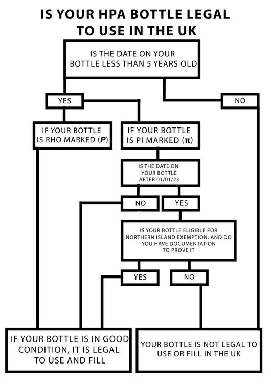

We have been given this as a guideline
I (think) that I referenced this somewhere on the forum last year.
The flowchart is broadly right, but fails to take into account test exempt small capacity aluminium cylinders, and simplifies some points

Below in italics are some of my notes from the UKPSF AGM of July 2024 (with the odd tweak)
The flowchart shows a ‘Northern Ireland exemption’.  This relates to the complexities of Ireland being UK in the north and part of EU in the south with no border.
The extract image below from the Department of Transports document “Placing transportable pressure equipment on the market in Great Britain from  1 January 2023” highlights that Ireland is one market and therefore Pi remains valid in NI - though the flowchart demands documented proof - what could that be?  An invoice - which could legitimately be from a French retailer selling to an NI address??
A players ID with an NI address??
A cylinder on the NI market??
The flowchart does not take into account multi national UNISO 11119 cylinders, which are internationally recognised, therefore may not be Pi or Rho marked
The flowchart tries to take into account hydro test cycles (by referencing a 5 year date.  It is not explicit as to which date is within 5 years - born date or test date.
(A non GB Pi cylinder born after 1/1/23 doesn’t become a GB cylinder if it gets hydro tested, but a Pi cylinder born before 1/1/23 can continue to be used in mainland GB with valid hydro tests)
Aluminium 3000psi cylinders also actually have a legal 10 year lifetime before hydro testing is required.  However many manufacturers mark a 5 year expiry (therefore an inspection should reject a 6 year old if the markings say so, but could accept for up to 10 years if the markings do not or painted markings have worn away)
An aluminium cylinder could be used forever if hydro tested, but at the cost of a test vs a new cylinder it’s hardly worth it
Low capacity aluminum 3000psi cylinders may also be exempt from hydro testing, this is generally called the 2 x 2 rule due to the US definition of “shorter than 2’ and slimmer than 2” diameter
This would cover common airsoft small
cylinders such as 13ci cylinders
So such a Pi cylinder born before 1/1/23 could be used forever in GB

(Notes extract July 2024)  …… post Brexit cylinders:
Pi is from European TPED and Brexit brings us to Rho certification
There are no Rho cylinders on the market ((((as at July 2024))))
If the born date is before 1/1/2023 then a Pi cylinder remains valid and can be hydro tested until death date
One or two manufacturers have been confirmed to be able to mark cylinders as Rho, but nothing in the UK yet (((as at July 2024)))
It’s likely that some fibres will be flown in but aluminium’s will only be sea freight
(Bearing in mind that <name witheld> used his DOT bottle everywhere except for me, x and y checking - so it’s a matter of who knows and who checks). <<player name and sites redacted>>.
Existing Pi cylinders are fine (pre 1/1/2023
If buying check the born date
Not sure how that affects multinational ISO
Technically speaking Rho counts at point of sale on the market, so buy in Southern Ireland and new Pi could be fine print legal for UK

As per the original post with the flow chart (which I disagree with due to over simplification) sites have been made aware and staff ought to be checking cylinders before filling (they should do so anyway)
