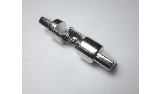

Update, fitted a new trigger box. Found a new problem! It fires single shot on auto, auto on single and the safety works fine
Selector cam 180° out?
Sounds like it could be.
WE SCAR Fire Selector Part 110Its a while since I had a mates SCAR apart , but I think that looks right. I'd suggest taking the selector out and flipping it end over end and try re installing . See if that does it.
