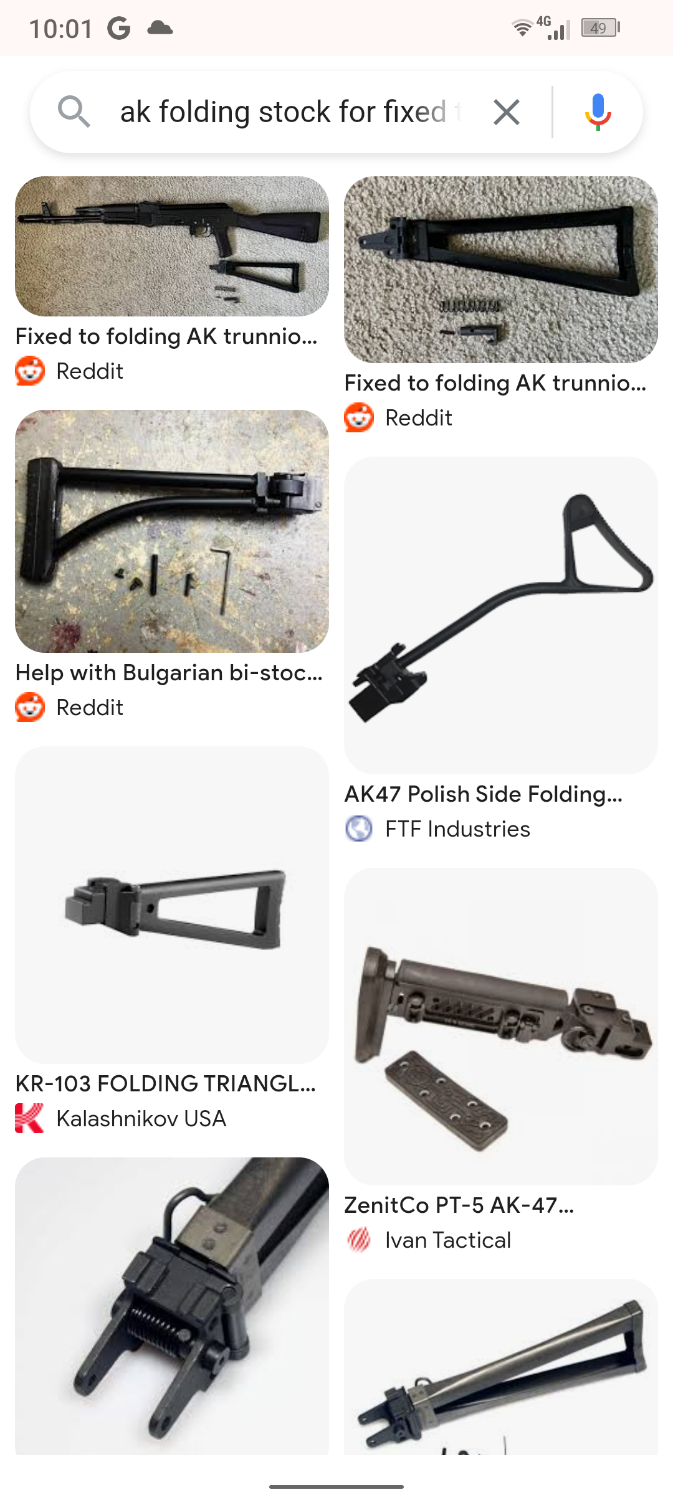

There looks to be a few actually. look up ak folding stock for fixed trunnion

The normal AK side-folding stock locks into a latch on the receiver, which is an issue for any that weren't built with a folding stock. (Unless you want to cut the hole and rivet the latch in.)
You're probably better off seeing if a Galil folding stock will/can fit. It folds to the other side but i think the locking mechanism is part of the hinge.
