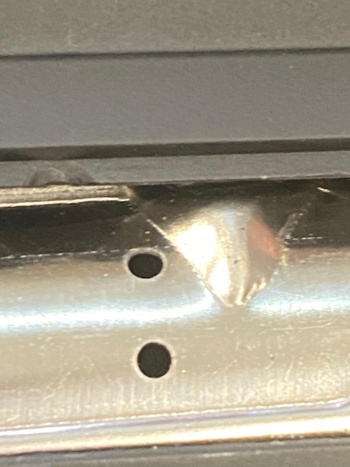

JinxDuh Posted August 20 Share Posted August 20 Hey guys, got my E&C M4A1 receiver set today from China and it's all good except one thing. Pulling back the charging handle doesn't open the dust cover, at all. The little "flag" that a lot of AEG M4's have on their charging handle, isn't on the E&C. No biggie, I have a spare specna one laying around so I'll fit it, I thought. The "flag" slides past the button on the dust cover and doesn't drop it. On the E&C M4A1 upper, instead of the area being flat like a lot of standard M4 uppers, it has a small sphere shaped (Kind of?) cut out where the "flag" should slot into and push the dust cover retention pin down. I'm rather lost on what to look at for potential fixes, etc. I also tried a specna m4 dust cover replacing the E&C one but the Specna was too short. Any help greatly appreciated to help me finish my MK18 build 😬 Link to comment Share on other sites More sharing options...

JinxDuh Posted August 21 Author Share Posted August 21 22 minutes ago, Lozart said: That's what mine looks like too (E&C M16A2 receiver set). To be fair, mine arrived preassembled so it's not been an issue but the charging handle end is like this: When I got mine it didn’t have the flag part at all, but the E&C flag looks different. How is your upper shaped? Image 1 is the E&C with the ball shaped cut out, image 2 is a Specna m4 upper with the “traditional” flat side Link to comment Share on other sites More sharing options...
Supporters Lozart Posted August 21 Supporters Share Posted August 21 16 minutes ago, JinxDuh said: When I got mine it didn’t have the flag part at all, but the E&C flag looks different. How is your upper shaped? Image 1 is the E&C with the ball shaped cut out, image 2 is a Specna m4 upper with the “traditional” flat side Definitely flat like your second pic. Where did you get it from? I take it it came in a proper E&C package and everything? Link to comment Share on other sites More sharing options...

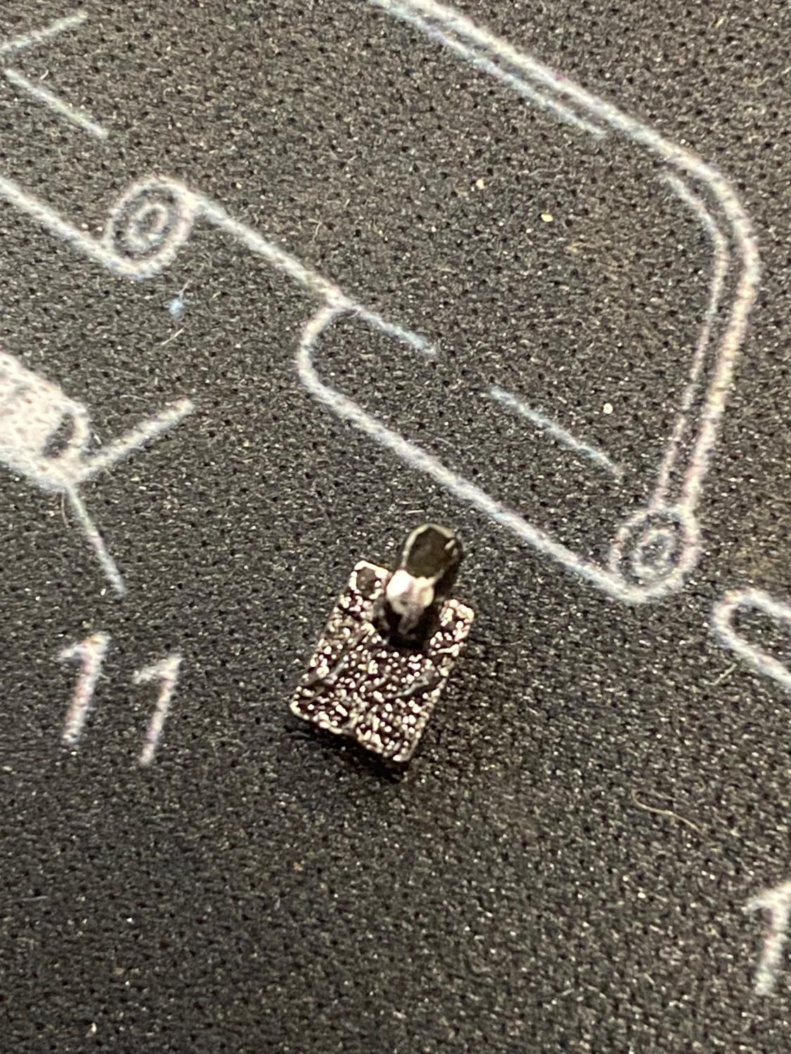

JinxDuh Posted August 21 Author Share Posted August 21 5 minutes ago, Lozart said: Definitely flat like your second pic. Where did you get it from? I take it it came in a proper E&C package and everything? 18Airsoft in China, yeah it was in an E&C box and all. I think I’ve worked it out. The pin is worn, the mock bolt should run along it and drop it down. A replacement dust cover is £14, so I’m just going to remove the pin and let it hang down (And save £14 😂) Bit annoying it’s worn so fast but 🤷♂️ Lozart 1 Link to comment Share on other sites More sharing options...
