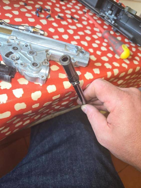

The boy's L85 has seemingly lost quite a bit of power,  sorting from memory 180fps on 0.28s last weekend.
It is a few years old now,  and spent nearly a year hanging in the wall.   There is a chance the spring was under compression during this time,  but the boy insists it wasn't,  and recent skirmishes had better performances.

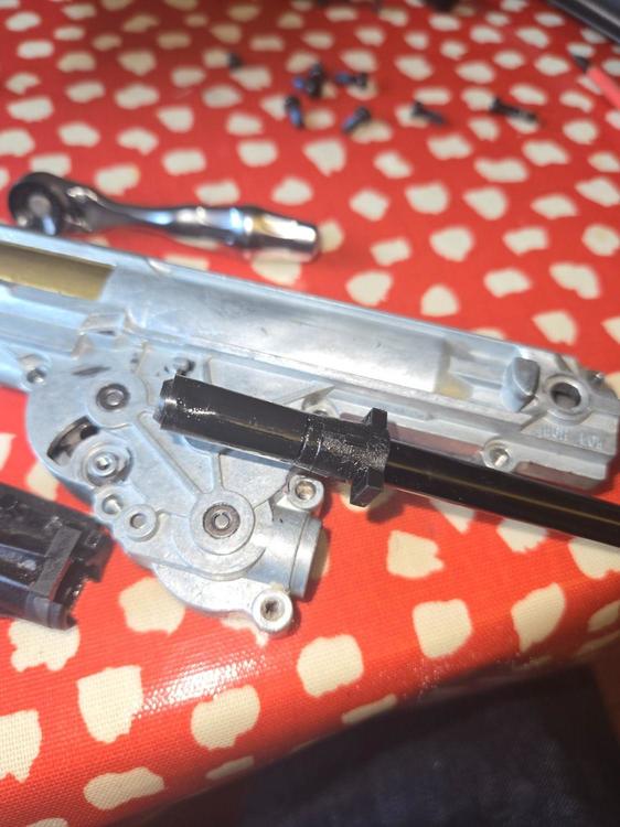

So I'm wondering if we're dealing with a worn up rubber?   The reasoning being I chrono'd it this afternoon on 0.2s, and was getting around 340 (assuming my device is accurate).
Could this discrepancy mean his hop can no longer lift the heavier weights?
Buggers have loctited one of the motor cradle screws in. 😡

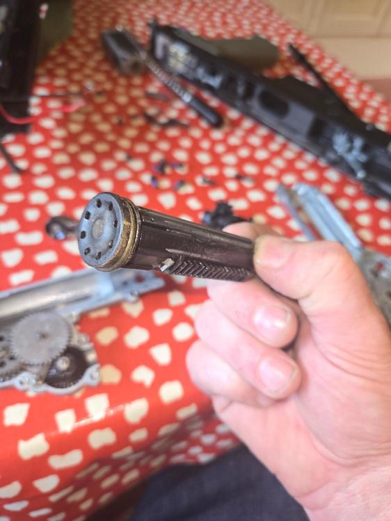

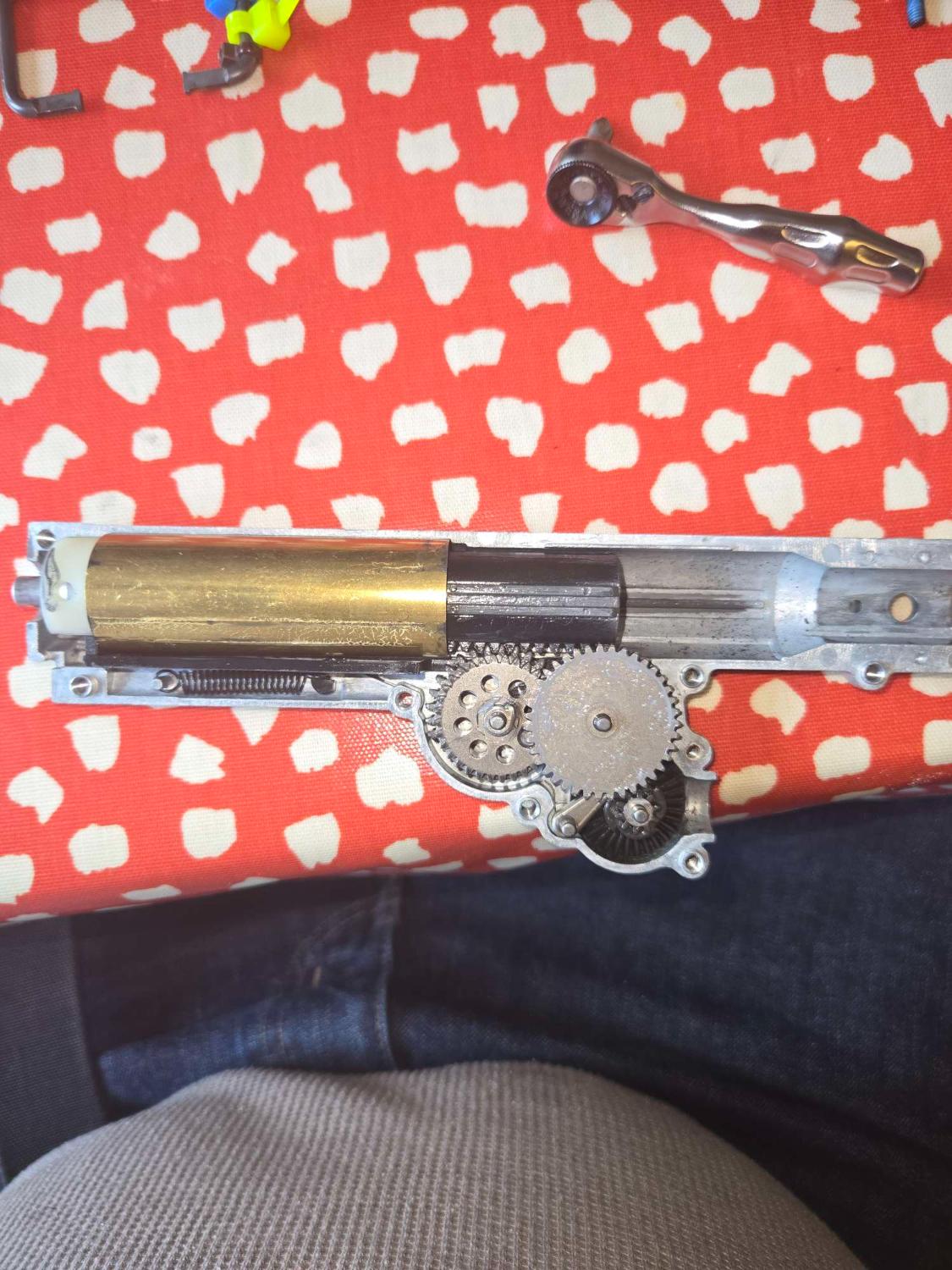

Anyway...cracked open the Boy's gearbox, and everything is tidy in there.  However,  @Sewdhull's thought on piston oring seems to be the culprit.  Very weak seal there.  Spring seems to be good, even though it was left under tension.
Does anyone know the best size oring for these?

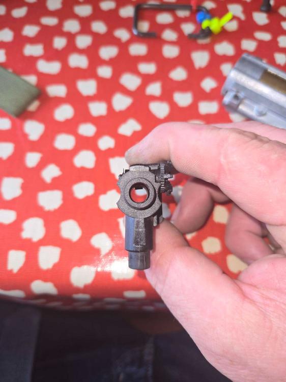

Bucking appears ok, although the nub seems to push through at an angle.

Tried a couple but none were any better.  Seems to be averaging 250 now on 0.2g which isn't great.  Get the occasional blockage if there's too much hop too.  Frustrating as we're now back to orignal parts.

Changed the bucking and made things worse....BBs were getting stuck in the hop and the gun sounded generally awful.
I suppose that's because of Maple Leaf rubbers having bigger lips?
Put the oem back in and fps dropped even more...plus the usual issue of not always selecting single shot.   *sigh*.

Next test is to swap the springs out between his and mine as there is nearly a year on his compared to mine, as its simple and non intrusive,  but I'm pretty certain it's something between nozzle and barrel.

Well....don't I feel a bit of a dick?!😮💨
Not sure how I missed this on the last few strip downs....
Teeth must have been disintegrating bit by bit.
Luckily had a few project/educational gearboxes lying around with metal teethed pistons.  Just chrono'd her and she's at 332fps on 0.2 bbs and zero hop.
Wonder how long my piston has to live now, plus why on earth did these get chewed up so completely?  The boy only ever uses 7.4v lipos and the box has never been opened before this probem started.... it didn't look like that when I first took it apart the other weekend (see the very first piccie).
