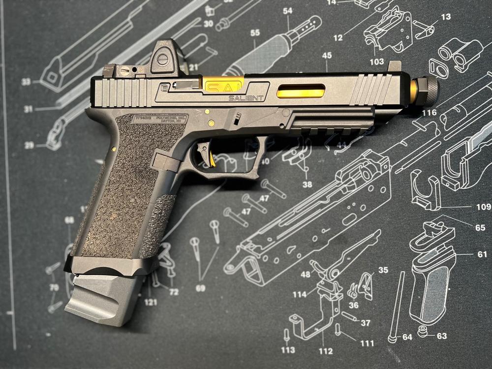

I’ve got 11 gen 3 glocks now and all have the same set up:
- Nineball purple air seal hop rubber
- maple leaf I-Bar
- airsoft masterpiece stainless steel hop arm
- maple leaf CNC hop wheel.
The game changer is actually the AM hop arm. It’s about 2mm shorter than the OEM hop arm, it allows you to apply more pressure on the bucking than the standard hop arm. Being stainless steel, it also flexes less than the stock arm.
You could also go for a better hop bucking, such as the pink flamingos. I rate them more than the nineball purple air seals… however, I bought all these hop rubbers before I realised there was something better.
I run .25s and 0.28s, but on full hop, my Glocks over hop 0.28s straight up.
if you’ve got the money, a good combination is also the guns modify steel hop, with their steel front frame and a barrel stabiliser clip. The 3 bits combined remove all inner barrel wobble and create a very consistent shot. That being said, some U.K. retailers would sell you those 3 parts for £220 ?
