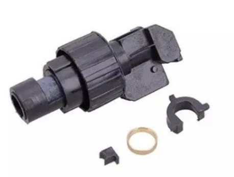

As far as I remember I have there this sort of HU chamber, I just remember not liking someting about it, not sure what was that.
If I can fit something more sturdy, that keeps everything stable, I can spend a little on something.
image.png.8ab27a06455da0ac68d2924e9c351d64.png or image.png.252c3ccb385ab56c0831f0f62de3e3cf.png

I'm not aware of an upgraded replacement for that hop unit. I did buy a spare when I cracked the rotary dial, but the functionality was always fine.  I run a Maple Leaf 60 bucking in mine, I can't recall if I've changed the nub or not.

Hey bud, so JG's are still one of the best G36's - Take that as you will...
As for hop up, I've recently had a lovely time trying to build a KA4 using JG parts so here is a list of hop up units that will work;
AirsoftPro CNC G36 Hop-Up Unit
ProWin G36 CNC Hop Up
BEGADI G36 Metal Hop Up
Lonex G36 Metal Hop Up (Personally, I love the Lonex one and up until recently it was my go to for hop ups)
Begadi/Maxx G36 Hop Up (Pricey, but oh my god - SO GOOD!!!)
The SHS one is... Okay. It's polymer, but it does work. I would avoid the Nuprol one, personally. I fitted one and it fell apart on testing!
I've tried all of the above, and honestly I'd recommend either the Lonex for a tight budget, or the Begadi/Maxx if you're wanting to splash the cash on gucci.

I think Initially I'll just go with basic maintenance & rubber replacement, and if my replica stands out in a bad way, then maybe this chamber & further fixes.
I just remember being super excited about airsoft when I was young & pretty, and it turned out to be closer to, well money waste for the time, so I'll take it easy.
Thanks for chambers recommendation,  I'll go for this Lonex as Im able to find it in good price in my country, If ill have trouble with the stock one.
