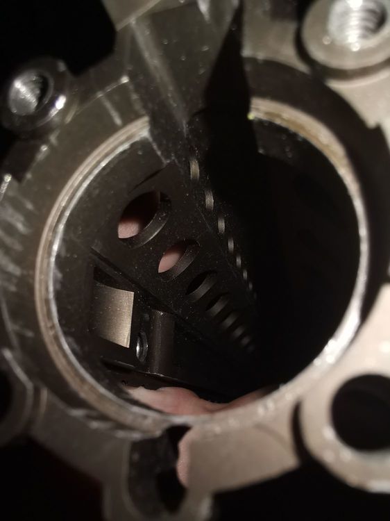

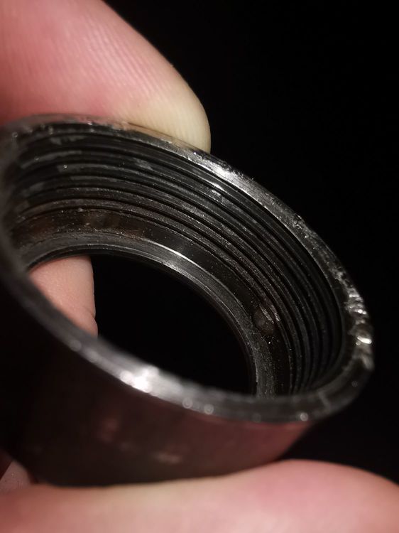

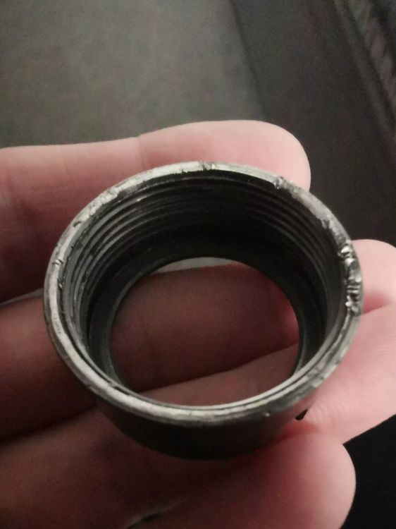

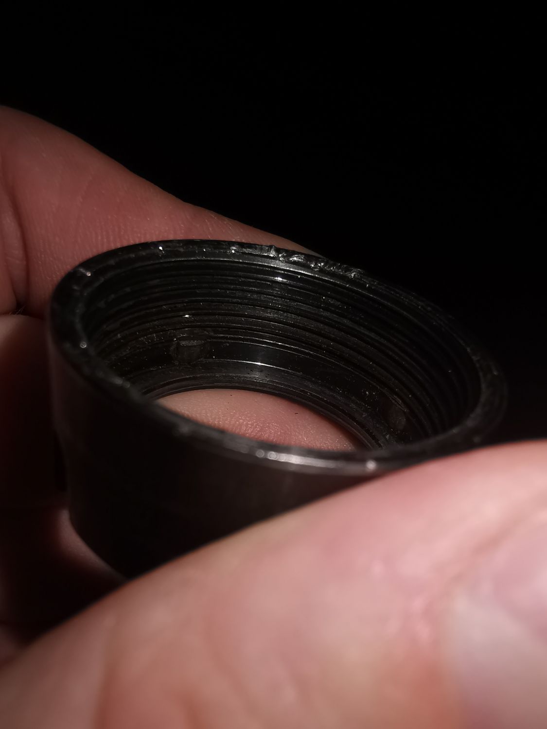

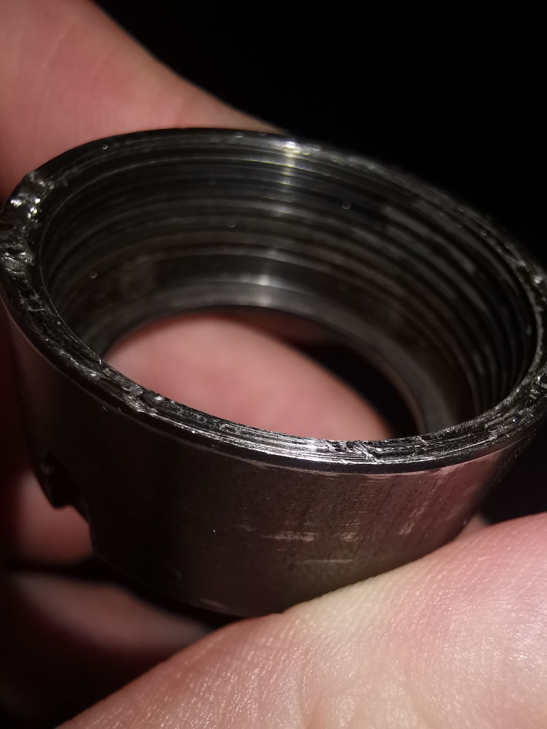

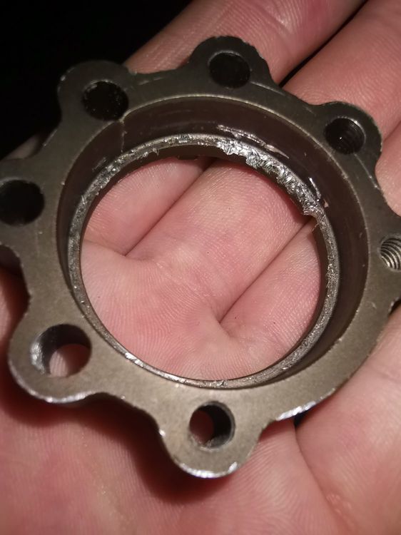

Updates with pictures. I've took pictures of the handguard where the barrel nut sits, a couple of the barrel nuts threads and one of the handguard plate which is particuarly battered.
Not terribly bothered about the state of the handguard plate, can be changed with the new one that i've ordered if that new barrel nut fits but i'm impressed how they've battered it that much.
Edited by MrTea

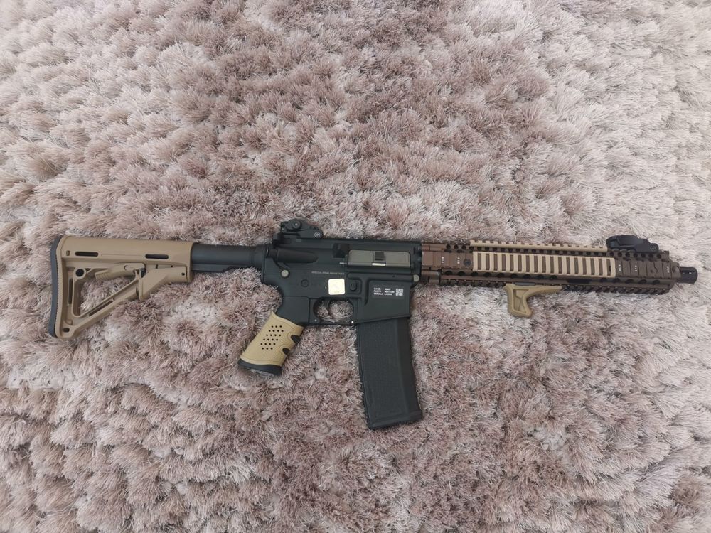

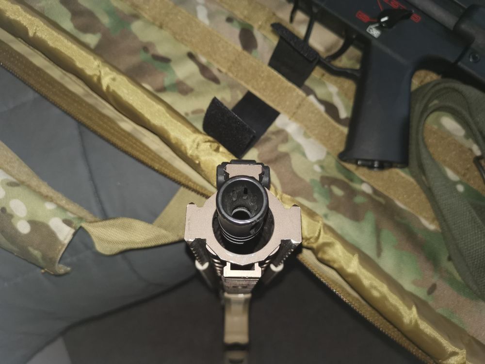

Well... after a couple hours dicking around with what is probably now my project or teching gun, the handguard is on! I tried both new barrel nuts to find that the GBBR barrel nut did exactly the same as the one the guy sent me so I think he's somehow forced it onto an AEG. The new AEG barrel nut that came needed backing off once or twice but threaded all the way down without issue. Due to the increased length of the handguard (over stock) I got lucky with a 1.2" barrel extention being the perfect length to let the flash hider sit just at the end of the handguard. I slapped a spare handstop and RIS rail covers on to see what it looked like.
Now it's on, i've ran into a new, interesting, issue thats difficult to see from the pictures. The outer barrel is leaning/pulling to one side. It has zero movement up/down, just left to right. I already used a varying number of barrel shims to fix this issue with no luck. I'm now planning on a couple of options to fix this.
  1. First, I could try using some padding/filler inside the handguard to essentially shim the outer barrel where it's least supported at the front.
  2. Second, cable tie or wire shenanigans to fix the outer barrel in place.
  3. Third, anything anyone else can suggest to fix the problem.

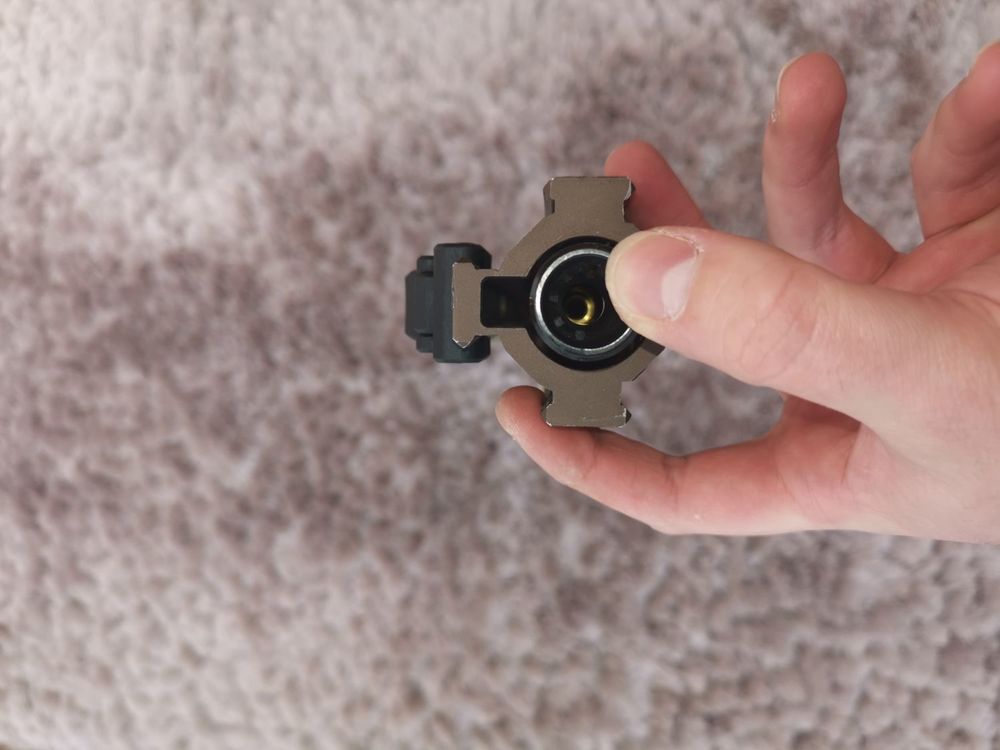

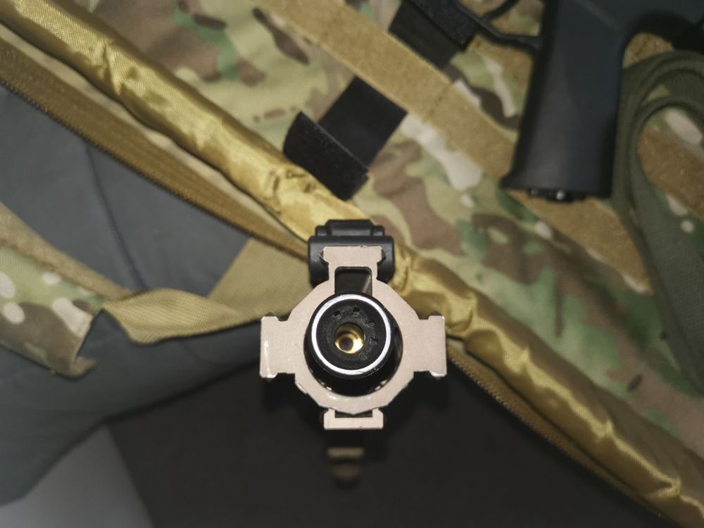

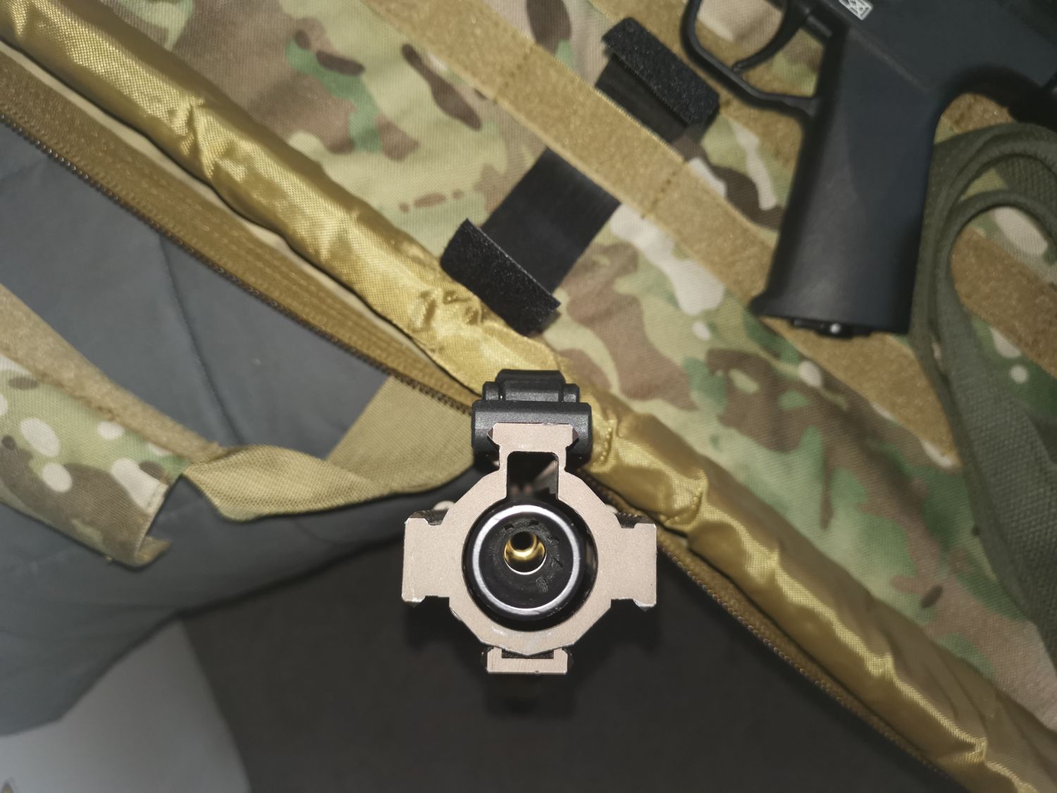

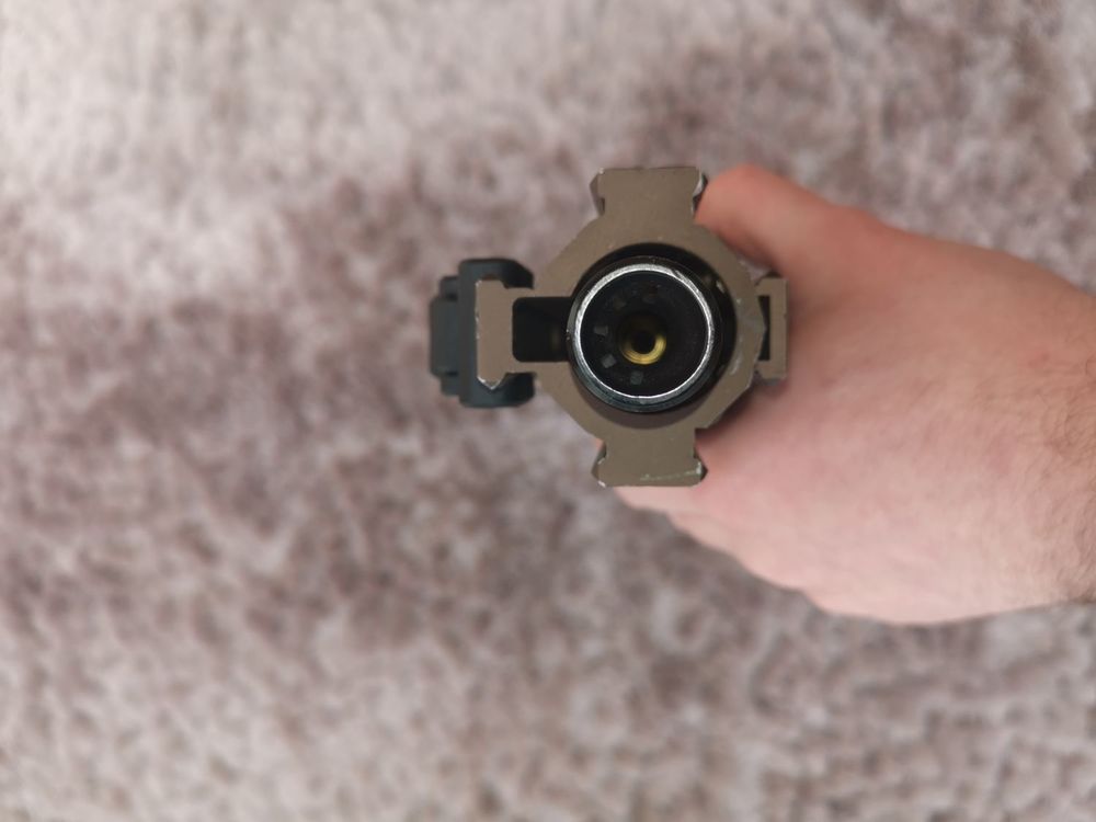

Took another couple of pictures to display what the issue is. I've tried adjusting how many barrel shims i've used to no avail. Someone on some long forgotten forum post suggested nipping up the grub screw on the outer barrel so I tried that. It's almost eliminated the wobble in the outer barrel but it's clear it's sitting off centre of the handguard. Aside from the cable tie method mentioned in this video i'm drawing a blank on what else to do.
Google brings up a couple results for barrel spacers for MK18 style handguards but they're out of stock almost everywhere or won't ship to the UK. Can't find any aliexpress wares for this either.
  • MrTea changed the title to Specna Arms Free Float Handguard Barrel Alignment Issues.
After a couple afternoons trying out different options between making spacers for the bolts of the handguard and tightening the bolts in a proper pattern I have accidentally fixed the issue by taking apart the outer barrel and reassembling it.
I'm not exactly sure why it fixed it but it has. The outer barrel is now pretty much dead center and has zero wobble. Not going to complain but it would have been nice if there was a clear and obvious issue causing it.

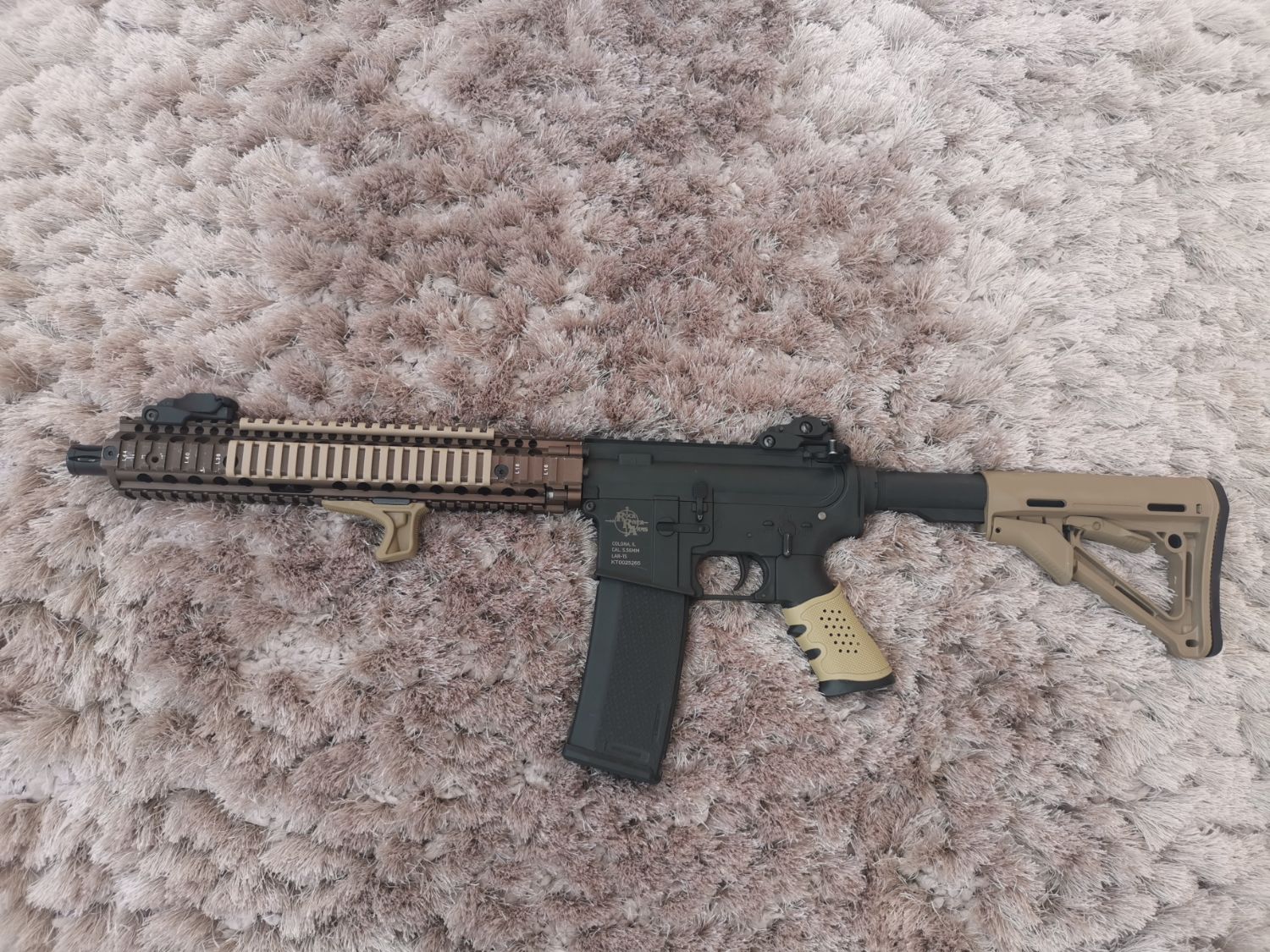

Another few hours working on the gun today. New compression parts arrived from AK2M4 and what a huge difference they are compared to the old set. I wish I had a chrono on hand to test the before and after. Had a bit of trouble installing the flat trigger (also from AK2M4) as the body pin for the receiver would block the selector going to safe and would bind the trigger. Took about 30 minutes of slowly dremeling material away from the middle third of the pin until the issue was resolved.
Put back together and tested. Working flawlessly and feeds fine with the new compression parts. Cannot wait to get this out to a field.
