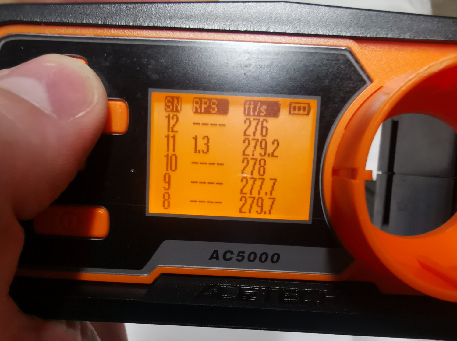

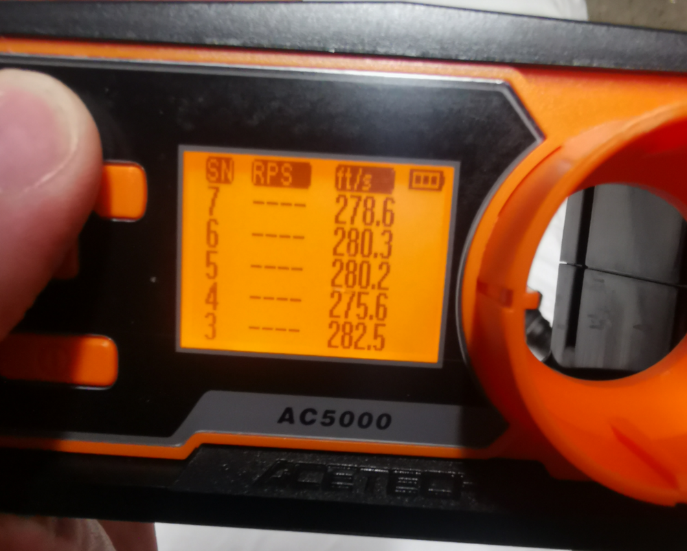

I'm back after installing the bucking, nub and prometheus 6.03mm barrel.
I picked up a chrono just to make sure I wasn't over any limits before I played with the upgrades. I tested it today after running about ~500 bbs through the gun. Using 0.28g BBs (without any hop applied (see pictures)) i'm getting a consistent 275-280fps range. Using a conversion table, this is sitting just over 1.0Joule and is around 325-330fps on 0.2g BBs. This is fine.
When applying hop, I found that the fps drops dramatically on setting 10 of 15. When I say dramatically I saw around 90-100fps loss when using 0.28g BBs. I understand applying hop increases friction to apply spin and will reduce FPS but surely not this much? Unfortunately I don't have enough space to adjust hop properly until I get to my local field and fine tune it then. Could it be that I was applying an excessive amount of hop and gripping the BB too much?
Any ideas welcome and i'm sorry I didn't get pics of chrono with hop applied.
