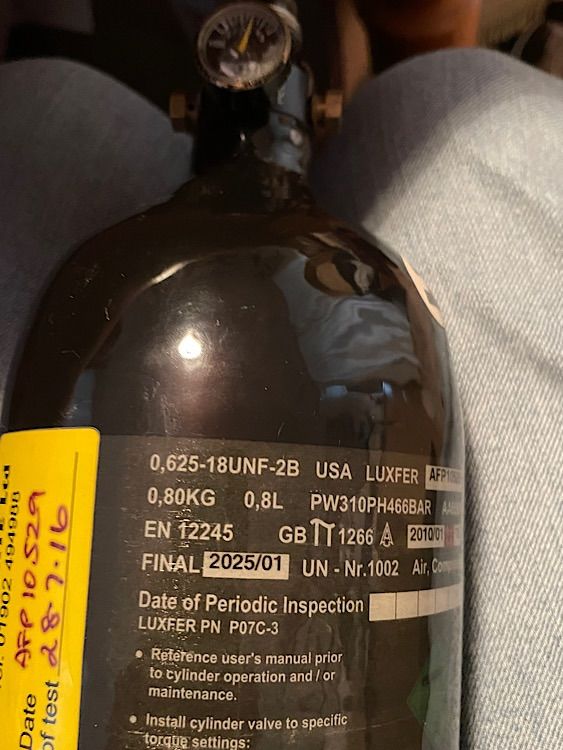

There should be another set of markings, like on here:
Note on the top dial that this still has air in it, but it is currently out of test and cannot be refilled.
Near the middle is the Pi gate symbol, so it’s UK & European legal
To the right of that is ‘2010/01’ (manufactured January 2010, and was therefore due for testing in 2015)
Left and down a bit is the final date of 2025/01 (therefore it becomes a paperweight from February 2025)
The big yellow sticker shows testing at July 2016 (which means it could not be used for all of 2015 and half of 2016, and also that the test expired in July 2021)
I can technically use the air that is in there, but cannot fill it as the test has expired. When I get around to testing I will not get a further 5 years as it’s final date is 2025
