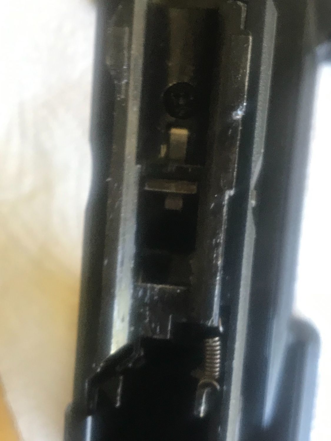

Edited by emilianoksa
Which serial/safety plate are you using? (ie the TM or one which came with the frame)
The one which came with the Guarder frame.
The spring below the takedown lever doesn't have the strength to keep the lever up. Do you think using the TM base plate/sliding safety might be the way to go? Or is there another way to go. At the moment the lever is just loose in its two slots.
I have been trying to download some better pictures but I always have trouble reformatting them from my wife's iphone.
The one of the recoil spring does not really show how much it is kinked. So I'll try to download another.
I always experience this issue when using a Guarder serial plate with a TM front rail. From memory (I've got one on order) the underside shape of the Guarder version makes up for the gap caused by the smaller serial tag, effectively shimming everything and applying more pressure to the little arm bit under the takedown lever. I know it's not ideal but you may well find that the takedown lever issue is fixed by using the TM serial plate.

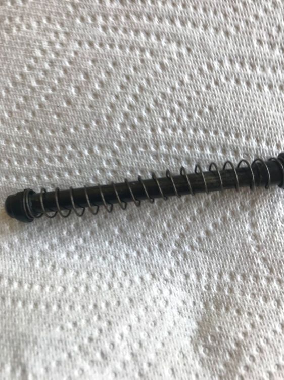

Here, I hope is a better picture of the recoil spring.
This is the way it came in a brand new Glock 22 which I purchased two weeks ago. It seems to work but clearly doesn't lie well on the guide rod.
Is it really supposed to look like this?
How do I get the spring off the guide rod? Which end comes off? And does it pull off or screw off. And why is there a flat indentation on the rod itself?
Would appreciate an explanation.

Yeah they state you shouldn't use the black plastic bit with the gen.2 frame but even with that you can see that the total size is still a lot smaller than the TM serial plate and obviously doesn't extend under front rail like the TM does. If you're up to the task, shimming underneath that little V shaped bit (which applies pressure to the safety lever), may be your best bet. I can never be bothered with this and either make do with the TM serial or purchase the Guarder rail.
Thanks again.
I doubt it would be possible to put the TM serial plate in the Gen 2 frame. It tapers quite a bit.
The Gen 2 has always been my favourite Glock and Guarder is the only manufacturer that makes a Gen 2 frame. I'm not keen on pistols with rails for lights. I prefer the cleaner lines of those without, which is a nuisance since so many come with rails these days. I don't skirmish with pistols so I don't really have a need for a rail.
Glad you’re getting there. Can you bend the take down bar spring open more to put more pressure on the take down bar?
