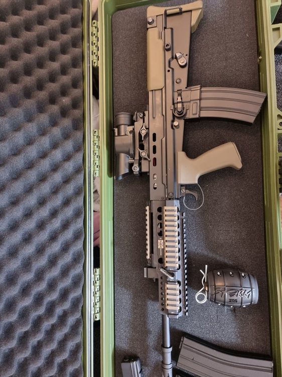

Hi, new to airsoft and picked up an L85A2.
I've got the adapter block I'll need for the Defence Rail, however, because I bought the rail second hand there is no screw with it.  The ICS Defence rail seems impossible to get hold of, so just wondering if I was to buy a new Defence rail (G&G variant) would this come with the screw I'll need to fit it to my ICS rifle?
Really hope so because I've bought one lol. Had a nightmare trying to find a screw for the rail (which is literally all I need is the screw to go into the bottom of the adapter block)
Any help would be much appreciated

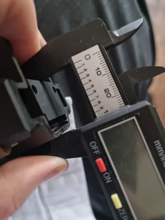

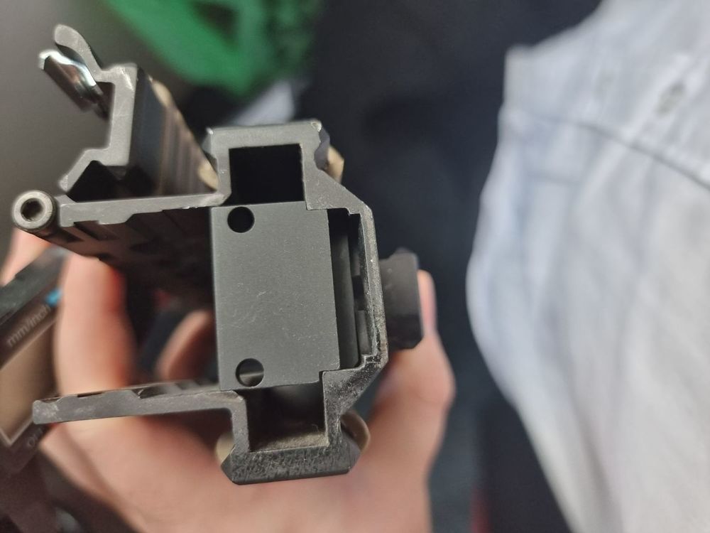

any pictures of where it needs to go ? An approximate diameter of the hole and length of screw / bolt and I’ll see if I’ve got anything that may help you out .

Thanks mate. Soon as I'm home I'll send a picture over.
So an M5 or M6 bolt at 25mm would be the first choice to try imo .
im happy to have a rummage later and if I’ve got anything suitable I’ll pop them in the post for you if you like ?

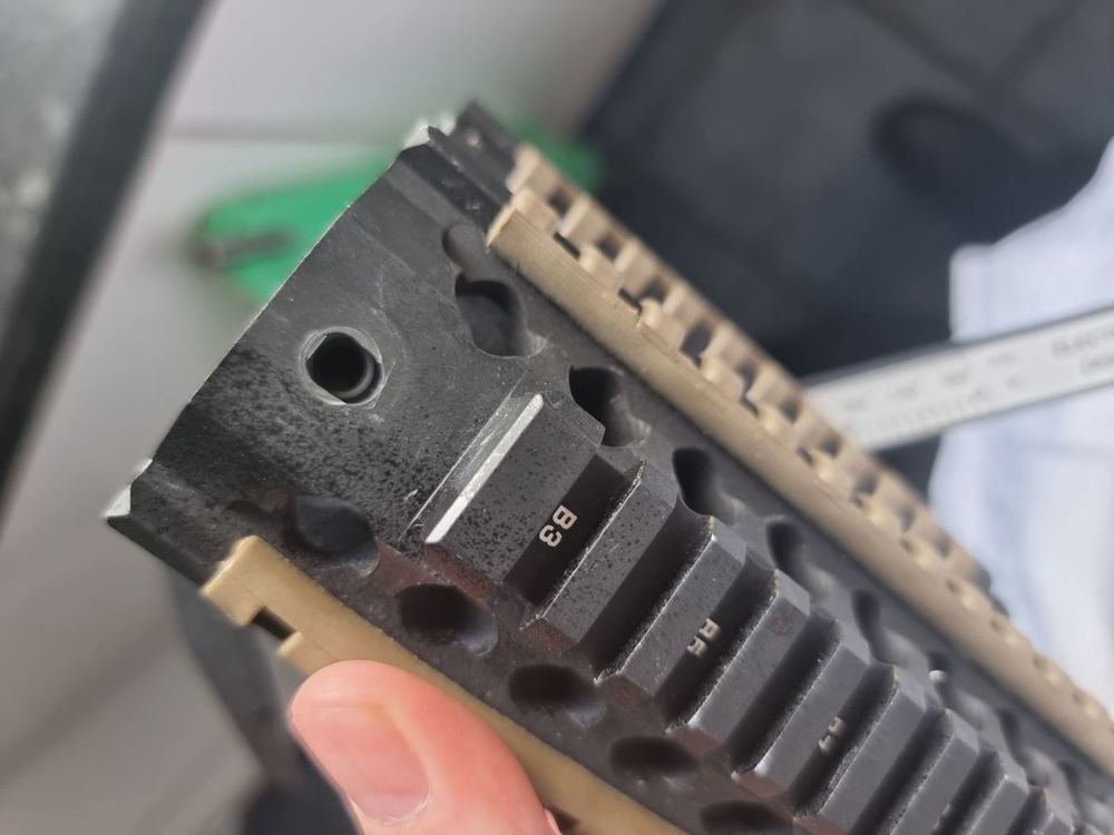

had a quick rummage , I’ve only got up to M5 here and only up the 20mm thread length , I’d happily stick a couple in the post for you but looking at your pics I think too short if you want it to go all the way through the block ?

Looks like they only go upto 20mm too though and I'm thinking it will be too short?

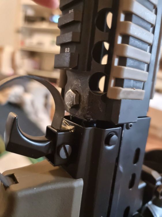

Finally got it sorted!
Got an M6 from screwfix and just needed to grind it down a bit, clean it up and it went straight in perfectly. Happy now that's finally sorted!
Thanks for the help
