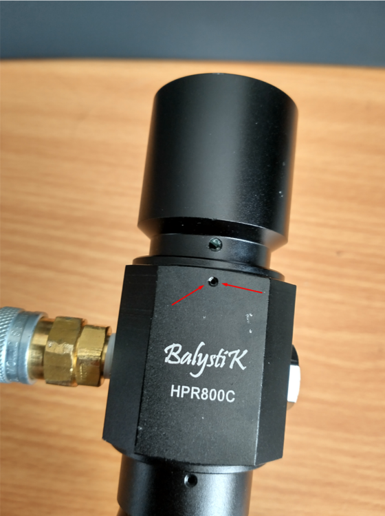

I filled up my tank and went to test all my gear today and the regulator leaking from the little hole at the back?
Not sure if I can fix this before tomorrows game :(

Mine had this issue, which ended up being the o ring on the bottle, so might be worth a look?
They are easy to strip down if needed. (youtube)

I was told never use oil in a setup so the regulator Orings do I just replace them instead of adding silicone oil?
Thanks.
Thanks.
A little Silicone grease for orings is best .

Unfortunately I too am suffering from this issue - did you ever find out what the problem was?
So far I've disassembled and cleaned, and tried a few different bottles as well with no luck.
TIA :)
I think there was a bad batch of these a while back?  but thought they would have all been cleared by now!
Id contact where you bought it from just in case.
