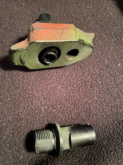

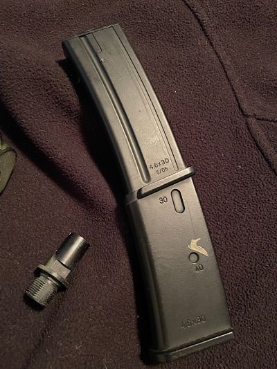

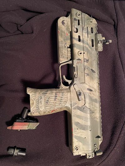

I’ve bought some pieces in an auction bundle, which includes this TM MP7 AEG
I believe that I have a partially complete MP7, though untested
Questions would be:
Is there any practical problem with not having the barrel tip?
(I believe that it has the glow BB adaptor)
Assuming it is the glow adaptor, what should I look for?
There is no battery, and I think it needs a particular battery (and therefore the right charger)
Any advice would be appreciated

you can fit any -14mm tracer unit onto the tracer adapter you have or try to find a replacement flashider for it (which isn't -14mm and is -11mm I think).
the battery is an AEP battery but you can Lipo's for it that will fit (search for TM MP7 AEP Lipo battery).
If it is stock inside then it will be firing around 230 so probably best suited to CQB games.

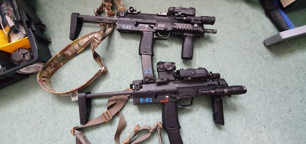

@Groot I dont suppose you remember what capacity and C rating lipo you used in your PEQ box do you for the MP7? I currently use a 7.4 V lipo, 680 mah 20C battery which fits in the barrel. But i want to use something bigger, but dont wanna destroy the gun.
