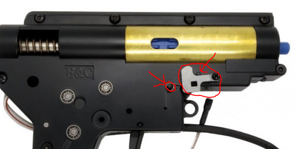

Just an FYI - E&C Gearboxes are not a straight drop-in for the Specna Edge - the mock bolt-release mechanism parts will have to be removed from the shell and the spring posts for said mechanism will need to be Dremeled-off.
I have an E&C GB in an Edge (supplied by @ak2m4 a year or so ago), and once modded fits fine.
Cheers buddy, that seems easy enough. Just need to find one now
