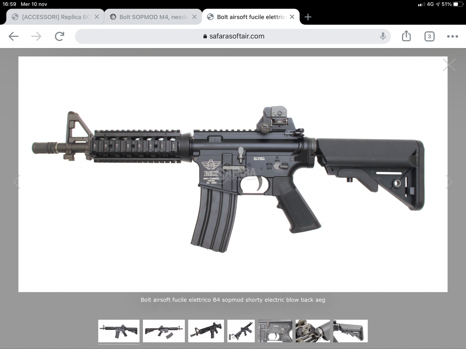

I'm a new member and new to airsoft world. I'purchased a Bolt SOPMOD M4 replica and I want to complete it with a silencer or with the Acetech Bifrost tracer, but I'm stuck with the muzzle diameter... the 14 mm suppressors are too big and l haven't found any info around on the measure needed on this particular type of replica.
Looks like it is something around 12mm but I'm not sure, is anyone able to tell me what type of diameter/adapter should I use with this Bolt replica?

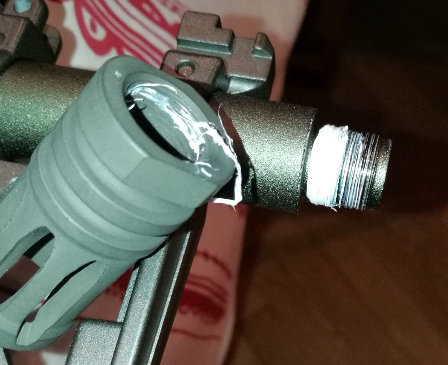

Hi thanks for answer, yes you're right, something's wrong... Bolt has just this morning answered me that the barrel of my M4 thread is 14mm and that not all the 14mm accessories fit due to producer's tolerances... but that's annoying.
What I am testing are these, my M4 and this generic 14mm low quality silencer you see.
As soon as I get home I might send you more specific measures you need.

Thank you, but I found that the problem is the BOLT barrel... it's a real crap!
I measured it with a caliper and it's less than 13.4mm, very poor manufacture I already need a teflon tape even with the original flame suppressor.

Yeah, 13.4 is pretty poor (it should be a minimum of 13.7 really). You could just swap out the outer barrel for a better one (Cyma do some good ones that don't cost much).
