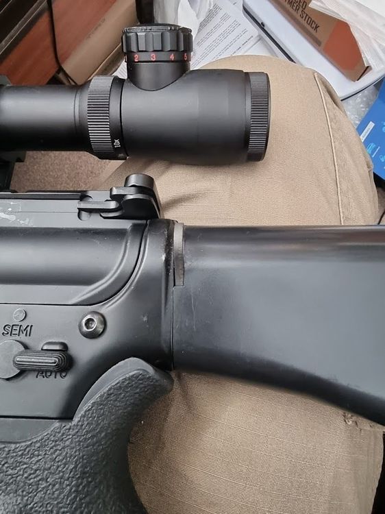

oh wow it’s just that simple; do you recommend any specific brand of m16 stock, do you mind if I see a photo of you weapon to see how the stock looks

Sure, mine's a MK12 built with an E&C M4 receiver but the stock was second hand. There is a Cyma one that has the adjustable stock plate that is a bit more SR25 accurate though.

This one comes with all the parts you'd need: https://www.davescustomairsoft.co.uk/external-parts/stocks-and-stock-related/cyma-m4-m16-aeg-full-stock-with-adjustable-butt-pad.html
