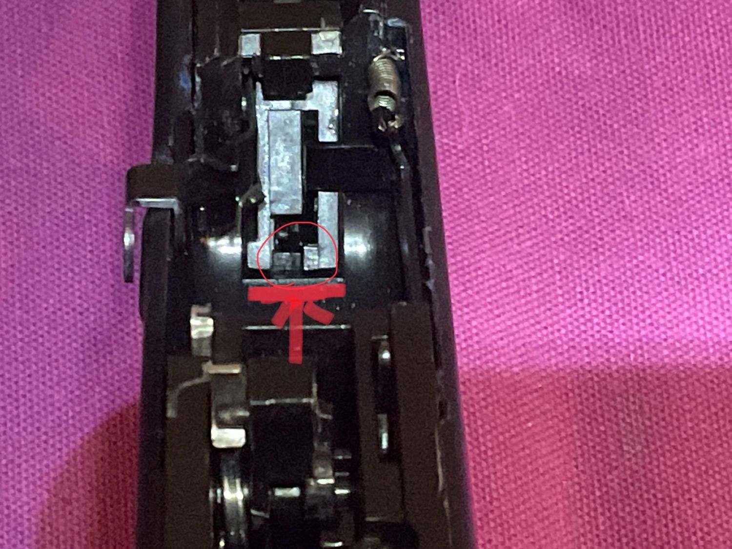

So, piccies!!!
Comparing this to another 17, I think there’s a roller missing.  Red circle. So ordered one that looks similar.
if that doesn’t work,  I may get a WE/TM compatible hammer group.

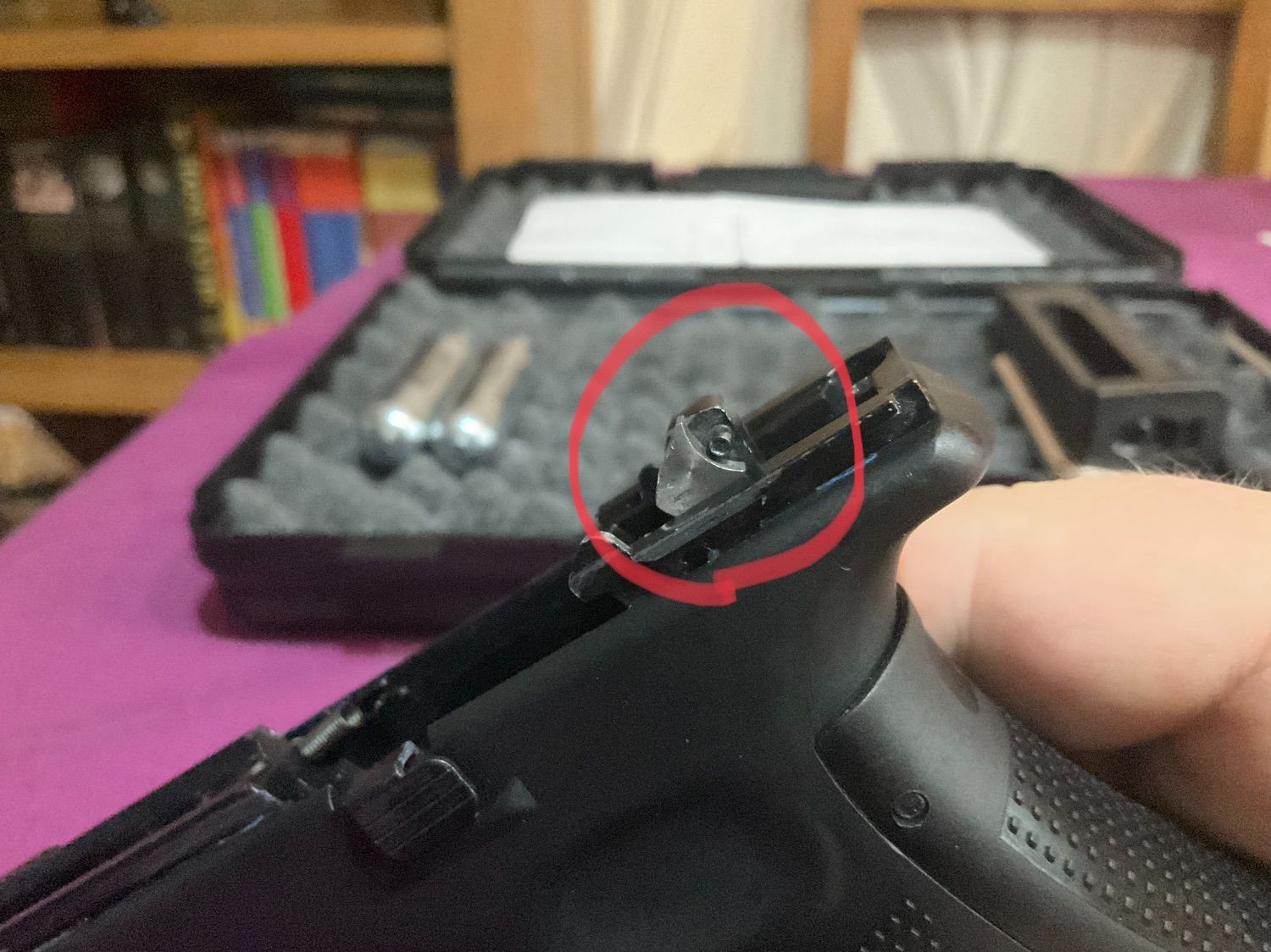

then on the inside, looking down and forward towards the barrel.
the middle paddle on the trigger appears to catch where the red arrow and line are.
it jumps over eventually and it feels like a long travel as well.
new trigger or is there a way to lift it up?
