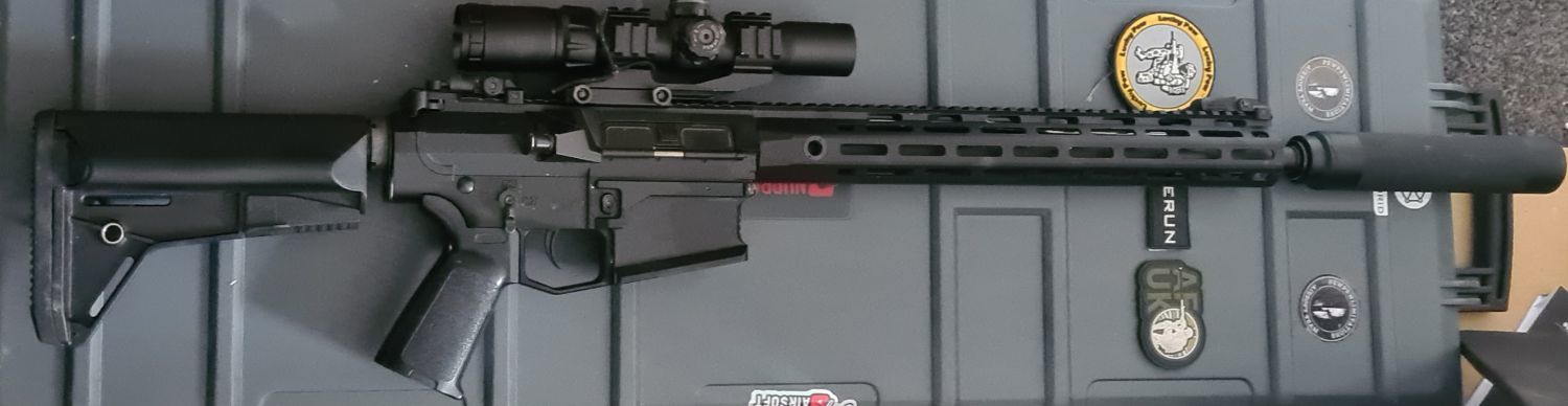

Sneaky Posted August 17, 2021 Posted August 17, 2021 I run the following for my CYMA SR25. Advanced Gate Titan - Can do great setups. 6.02mm TN Barrel R Hop Having a quick spring change system is great to have. I will get try it out properly this weekend, cannot wait.
