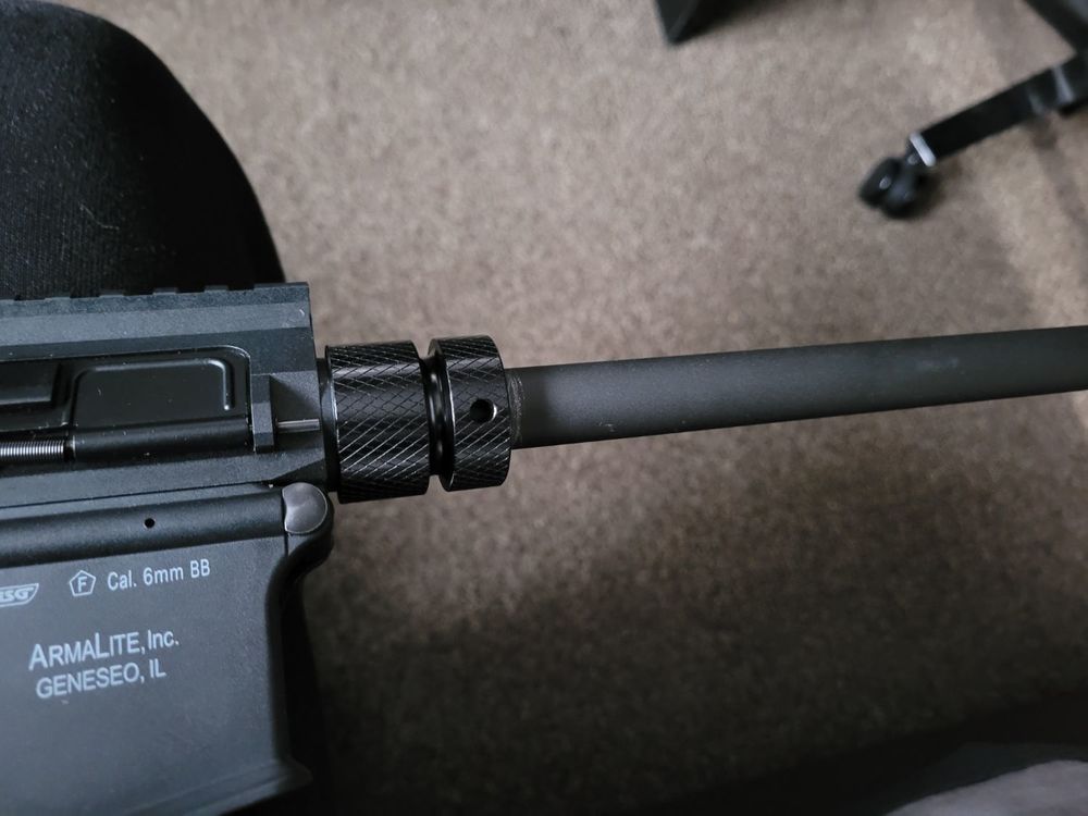

So I'm wanting to add a Nuprol Bocca Series Two rail on my gun. Can't find out anywhere on how to remove this type of barrel nut, any advice would be greatly appreciated.

I reckon a standard armorers wrench would do it.

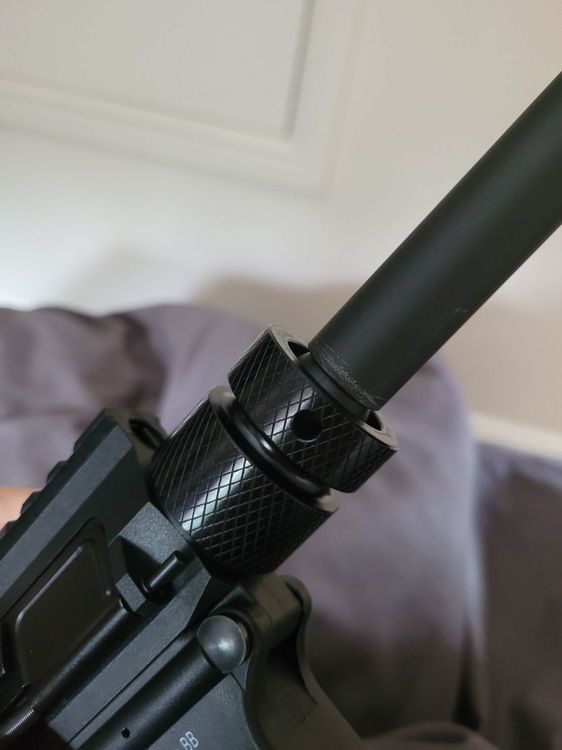

Cheers, any specifics on how to do this? Will be my first time removing the barrel nut so I don't want to end up bending the inner barrel. I'm a wee bit scared not going to lie haha. Also, I've attached a few more pics.
Stick the nub on the wrench in the hole on the barrel nut and rotate:
