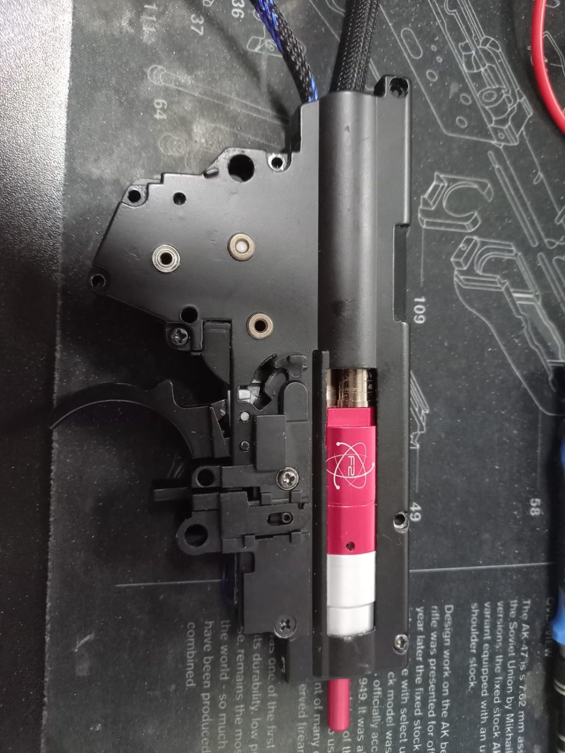

Adan Posted August 27, 2021 Author Posted August 27, 2021 To follow up my project of converting HPA into an ARES G36, To answer my own question, yes it is possible although it's difficult to find Polarstar parts world wide, and long shipping times. I found the F2 engine on powair6.com and the nozzle (had to purchase nozzle and engine separately),the switchboard and reinforced hose from Amped airsoft, the FCU from Easy Airsoft. It required a few modifications, I needed to file a tiny bit (I reckon 0.1mm) of the F2 because it was blocking the trigger mechanism, also there's a cable that has to be soldered into the switch. To plug the FCU I required to put a mini-tamiya plug for the LiPo battery. So far looks good, I also upgraded the inner barrel from a 285mm into a 455mm 6.01mm madbull, with a madbull shark hop up rubber. The inner barrel is longer than the outer barrel so I included a silencer to cover the inner.

Adan Posted March 31, 2022 Author Posted March 31, 2022 On 25/09/2021 at 18:05, #blackadder said: I’d like to do the same (F2 into G36). How is it performing ? So far is good but the tuning was more complex than I expected sometimes makes dry fires, I used an extended inner barrel (madbull) and it's very precise on 30-40 meters so even using a scope is handy.
Supporters Adolf Hamster Posted March 31, 2022 Supporters Posted March 31, 2022 Dry fires sound like dn/dr, cant remember which is the opening one (the manual should clarify, i wanna say dn is opening delay and dr is closing delay) but increase that a tad might help feeding issues.
