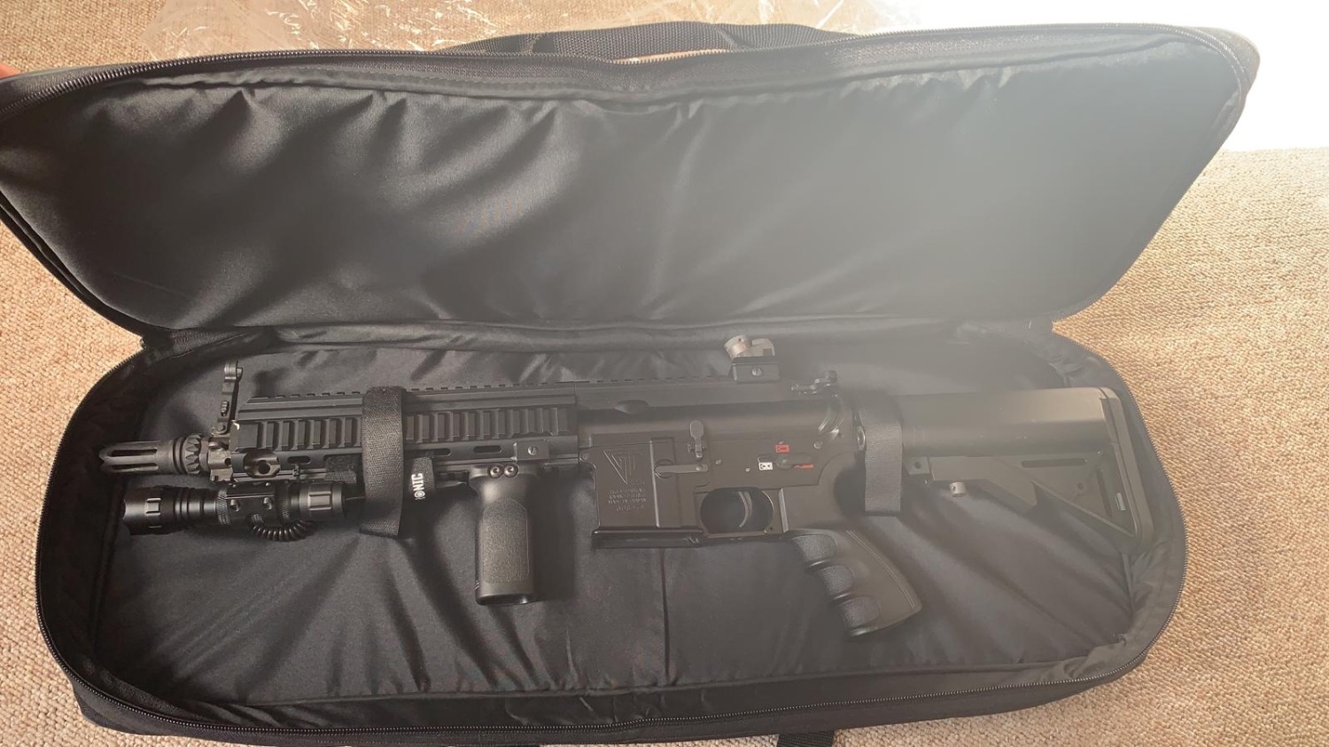

Hello all,
Before Covid back in 19, I played 2 games at combat south with a rental, loved it and spent about £400(including battery, charger and extra mag) on this great heavy realistic G&G TR4-18 the following day.
Can’t remember if it had issues from the first game but on second for sure, but then covid hit hard and time went on.
Very often, when on semi auto, sometimes it just stops and trigger won’t work and I need to put it on full auto otherwise it won’t work. Fire a few bb’s, I then change to safe, semi and works for a few more minutes and gets stuck again. Most of the times on semi it fires like full auto…Also 4 places I been so far they all say semi auto only.
Went back to the shop the other day to the nice gent and was willing to pay the repair(as is been a while and assume is not under warranty anymore) and when he tried to see what is the issue, it bloody worked perfectly well so I kind of looked like an idiot and he said something about pressing the trigger properly and not just to touch it slowly as it can feed more bb’s than just one.
Is quite annoying to be honest as I start firing and it gets stuck all of a sudden and then need to play with the switch until it works again while my teammates need me to cover etc.
Anyone had this issue and know what seems to be? I am using 11.1 V 1450mah Nuprol with 3 bars as recommended by the gent when bought it. Any thoughts?
please be gentle as I am not very knowledgable about things like: moffset, gearbox, stock etc, ? sorry still at the noob stage
