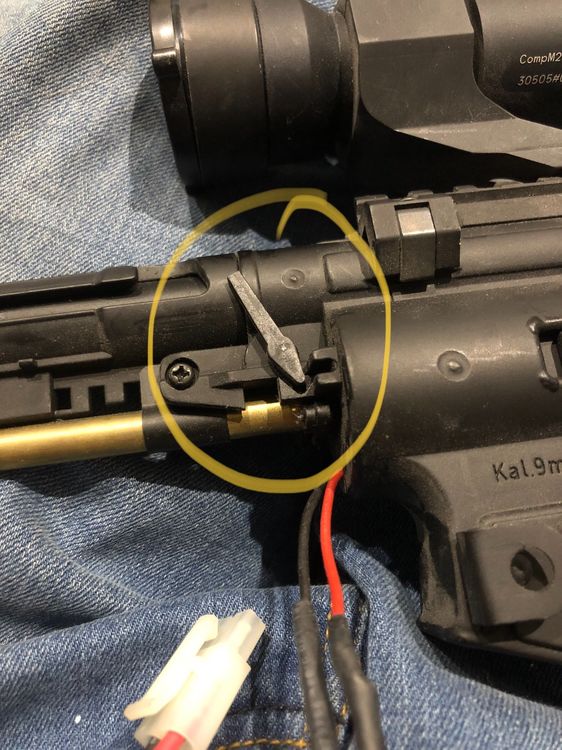

Nothingtoxic Posted May 12, 2021 Posted May 12, 2021 May seem like a stupid question but I’m wondering if anyone can tell me what this part is and what it does. ICS gun. Thanks
alxndrhll Posted May 12, 2021 Posted May 12, 2021 I believe that's the hop adjustment lever (or 'trajectory adjustor' as ICS call it in the manual). Source: ICS MP5 Manual
Nothingtoxic Posted May 12, 2021 Author Posted May 12, 2021 9 minutes ago, alxndrhll said: I believe that's the hop adjustment lever (or 'trajectory adjustor' as ICS call it in the manual). Source: ICS MP5 Manual Thanks for letting me know ?
Samwise Posted May 18, 2021 Posted May 18, 2021 Yup, I can conform that is the hop adjustment lever They do tend to vibrate loose during use so it's often a good idea to put a wide shim and even a small o-ring under the screw that holds the primary hop arm in place on the chamber. The one that the lever you've pictured goes in to at the bottom.
