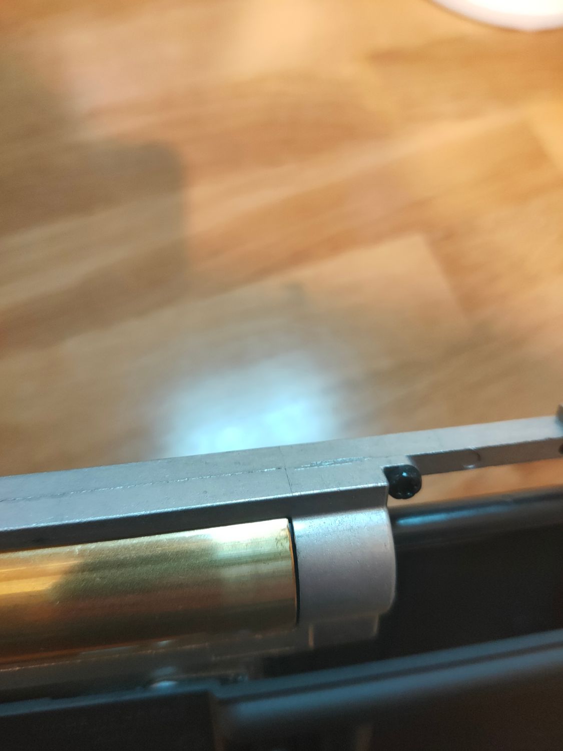

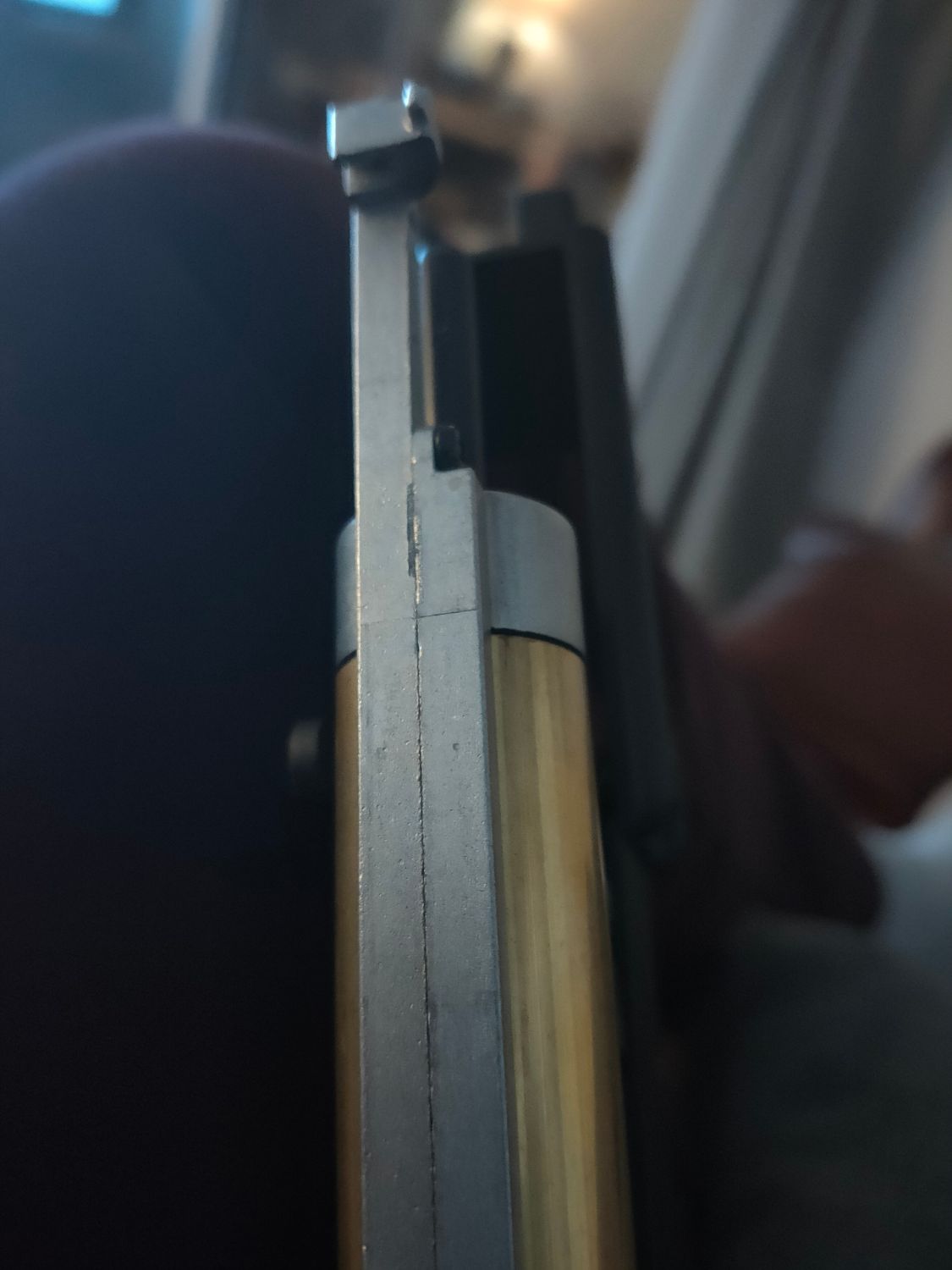

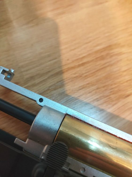

Was going to tear down my new TM and fit a few parts but I've been halted by something I've seen and don't want to go any further till I came here for a bit of advise :)
I've tried my best the attached some decent photo's and was wondering are these "marks" on the gearbox what's been left from the casting process or "god forbid" cracks? Now it is late and I've had a couple beers so my eyes might be letting me down here. I'm thinking they are casting marks as when running a flat edge over them there is a slight step (if that makes sense), also if a apply a small amount of pressure they don't seem to open up any further. I've had a look at some images on the net and have noticed shadows etc in the same places on a few of them but it hard to tell definitely.

I think it's safe the assume these marks are from the casting process. I've watched a few videos on YouTube and can see the same sort of lines in the same places.
Don't panic matey... These are TM gearboxes... this is how they are out of the factory... ;)
