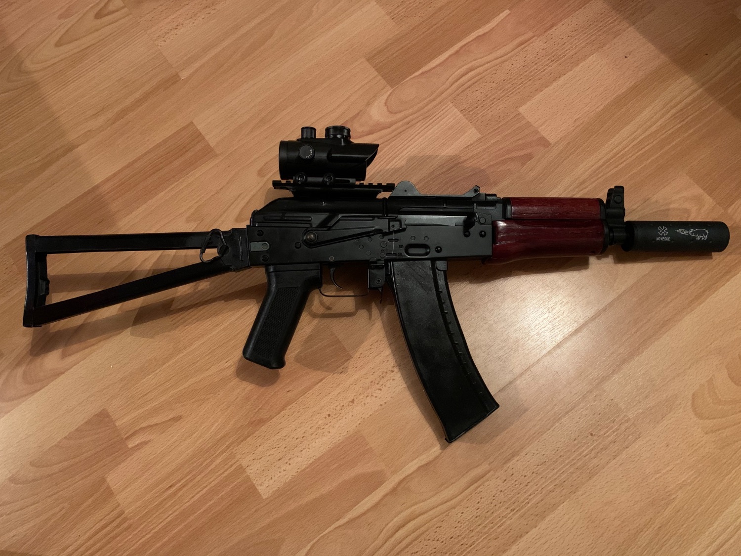

So after stripping down and seeing that a few things in my gearbox need upgrading, I am debating either just replacing/upgrading the worn parts or aiming for an increased ROF. Current basket/upgrades;
Piston & Head
Spring & Guide
Inner Barrel
Bucking/Nub
Nozzle
Cut off lever
all Springs
Mosfet
Current gears and motor seem fine however I am contemplating fitting a 13:1 gear set, bearings and new motor. Has anyone done similar and recommend any other things to consider or parts? I currently have a basket on AK2M4 just waiting on pay day!
