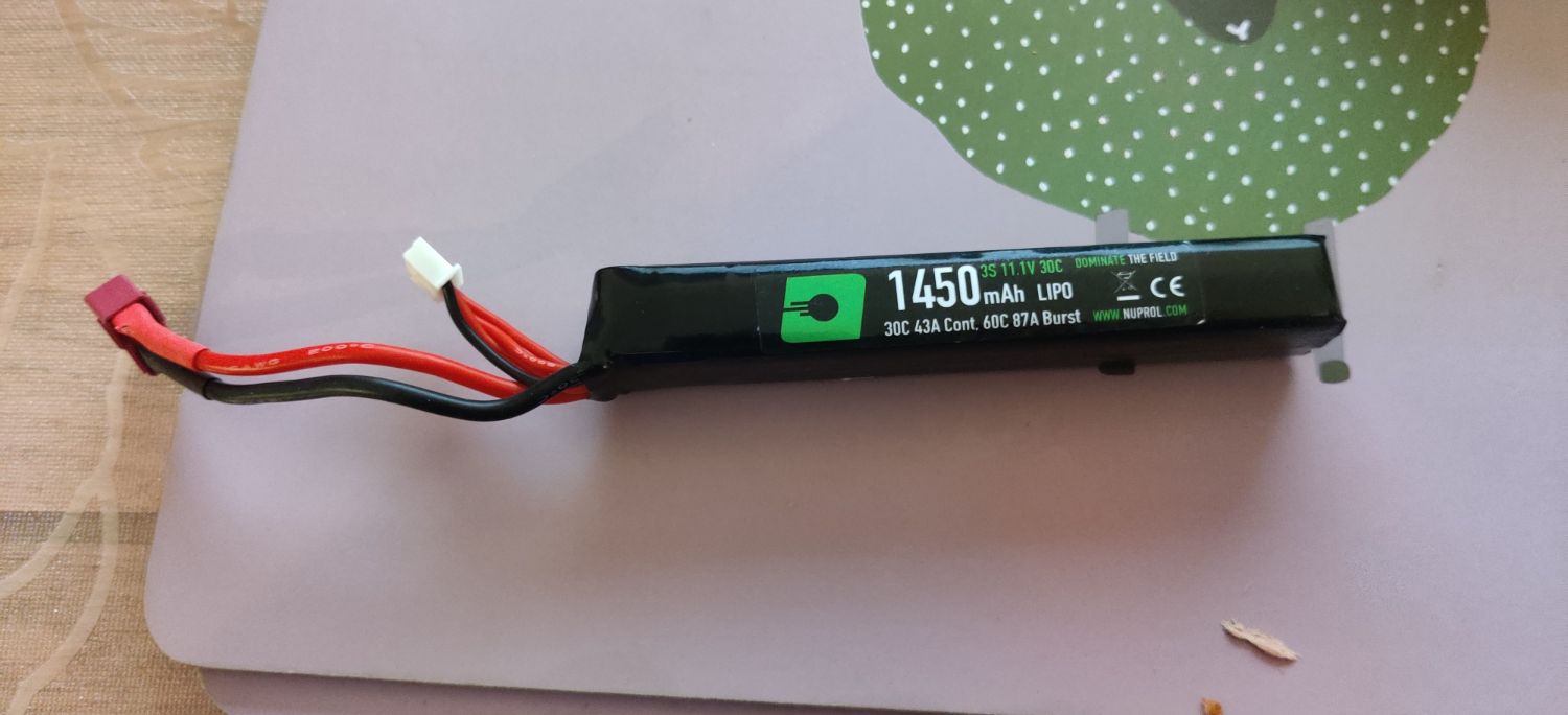

I am totaly new to airsoft and i hope you guys can help me, I recently brought a DANIEL DEFENSE® MK18 SA-E19 EDGE™ CARBINE,  i also ordered a 1450 mAh lipo battery 11.1v 30c(Nuprol) but it seems a very tight fit when in the back of the gun, (its a single battery)

Crikey. Not an 11.1 volt. You should get a 7.4v 1450mah. That will fit.
The 11.1v are bigger and you need to ensure your gun can actually support that much power.

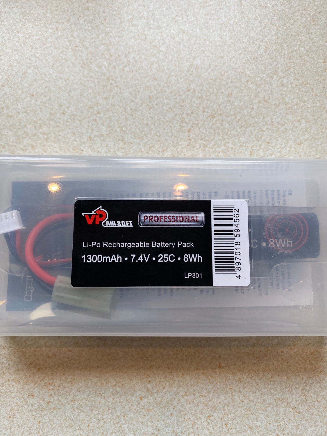

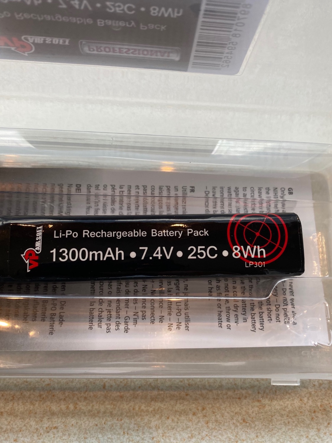

Correction:
it’s a 7.4v 1300 mah 25c battery. Get the VP airsoft one product code LP301
Buy two. They will last the whole day. In fact you may get away with one but just swap over at half time.
You do have a lot of space in your stock so get the biggest 7.4v that will fit in there.

So thanks for your help guys. I went back to the shop who have been really helpfully and they agree that a 1450 mAh lipo battery 11.1v 30c(Nuprol). Is the best match for this gun. They said 11.1 is more responsive and the gun has a mosfet in
