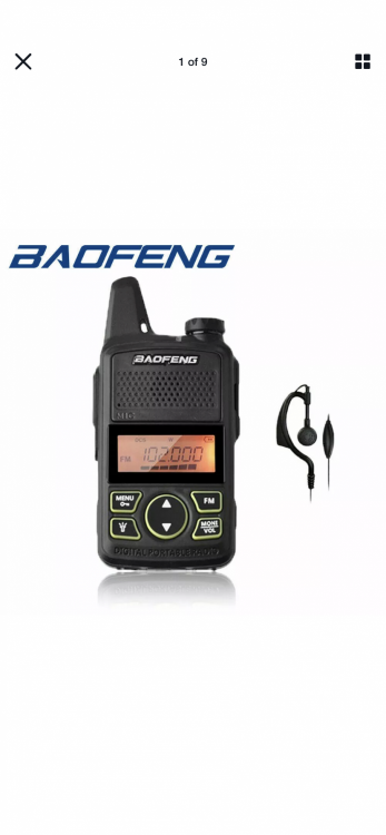

Any one used the BF-T1 radio for comms? Looking for a compact easy to use radio.
