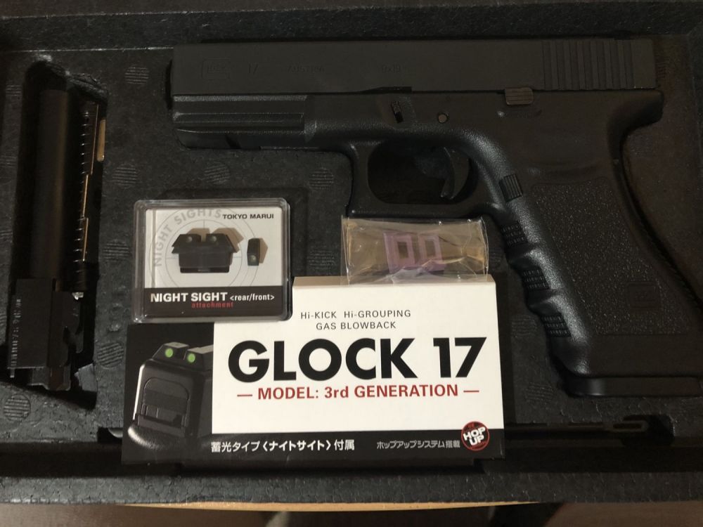

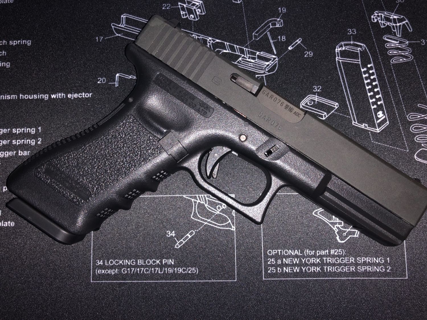

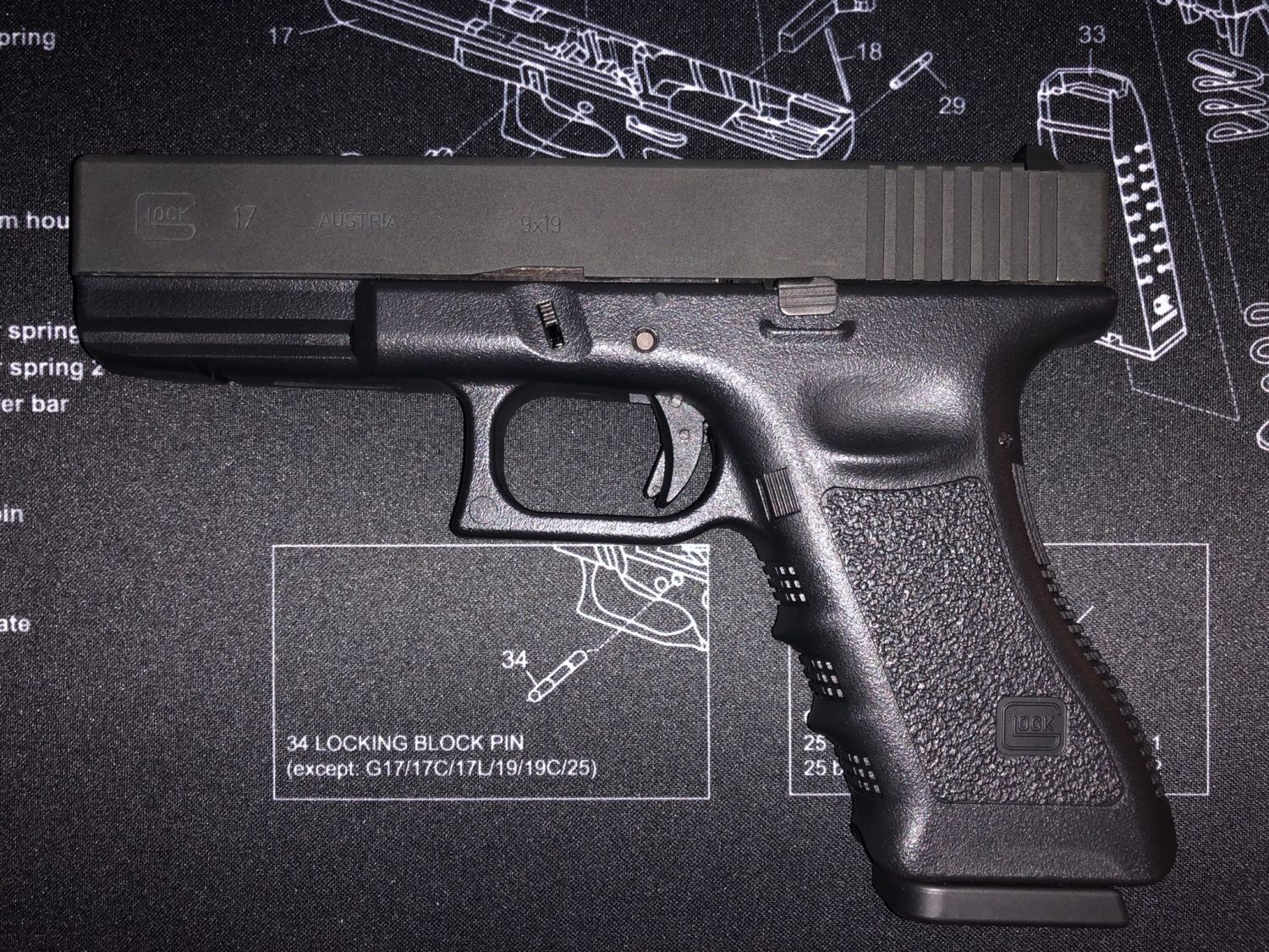

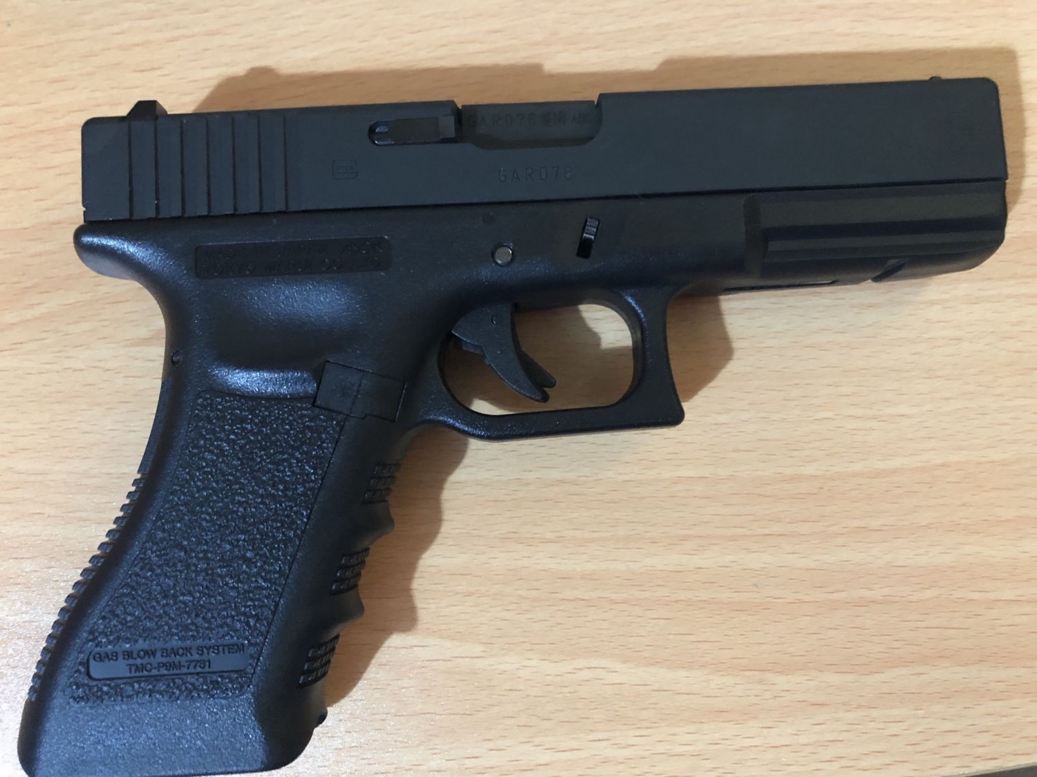

Modified/Improved TM Glock 17
Minimi124246
Make/brand: Tokyo Marui G17

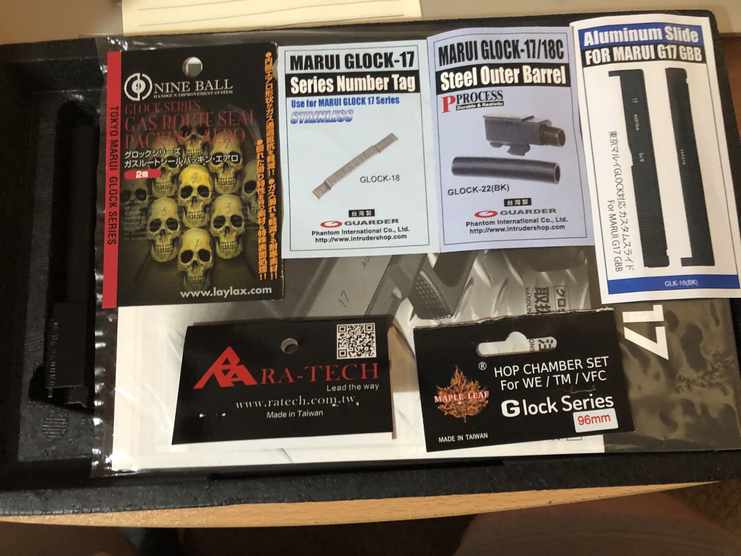

Any accessories included:
-Guarder Aluminium Slide
-Guarder Steel outer barrel
-Guarder frame serial tag/frame safety delete
-RA-Tech 150% Recoil Spring and steel recoil rod
-Mapleleaf Crazyjet inner barrel
-Mapleleaf Hop up unit
-Mapleleaf Autobot 50* hop rubber
-9Ball has route seal (1 installed +3 for extra mags)
-Guns Modify steel trigger bar
-Original TM night Sights
-Original TM parts that were replaced (Except stock slide)
This was a lockdown project for me, usually run KSC based Glocks. Just wanted a tinker really, I know what the build cost me to do, just trying to get a value really to see if it’s worth selling on or keeping as a wall hanger/occasional run and gun for pistol CQB matches. The base G17 shot 3 mags off to test function, then once completed this build has fired another 3 magazines worth, again to ensure correct functioning.
What would you guys & gals expect it to go for?
Thanks ?

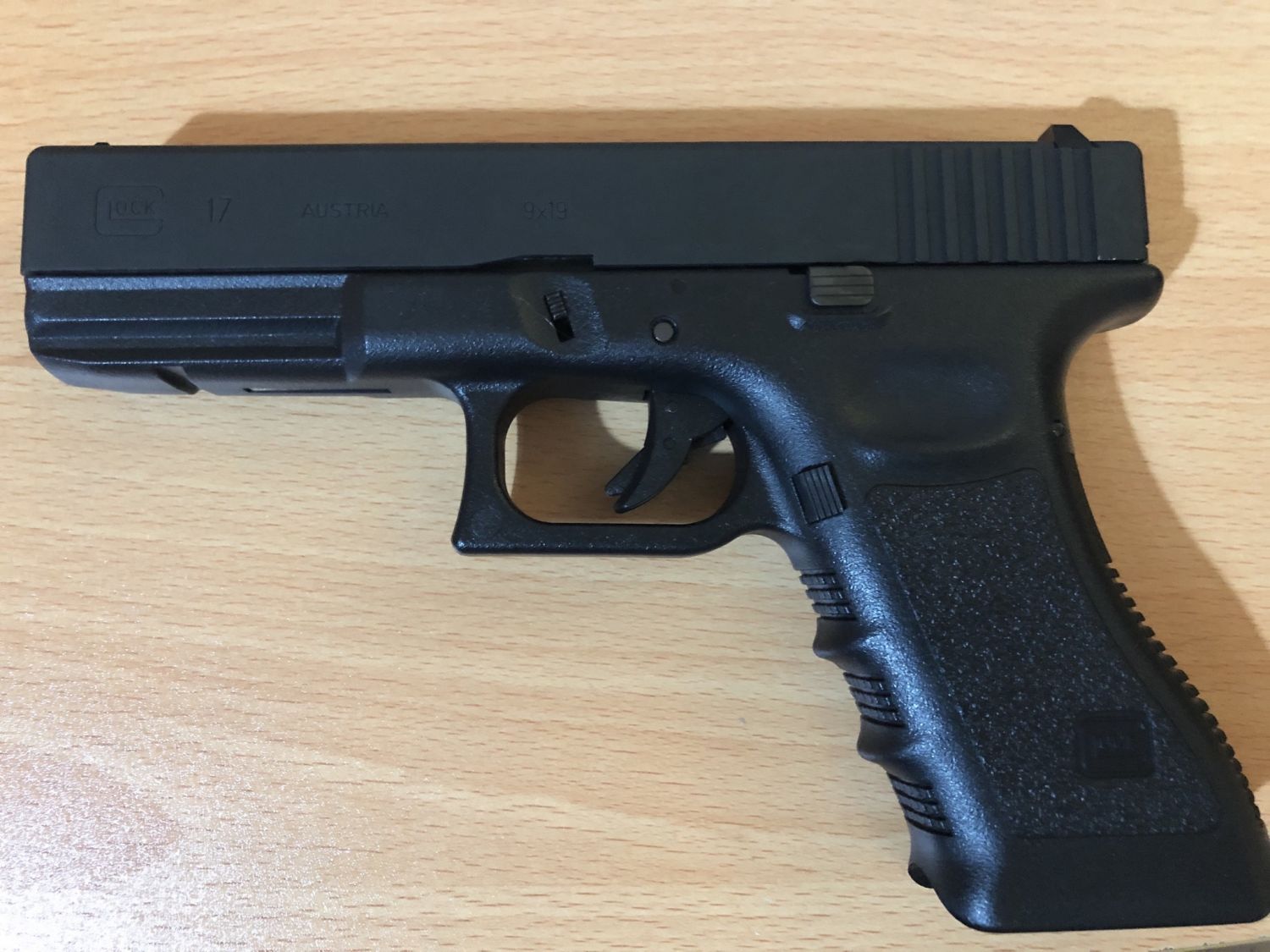

Pictures: hopefully attached.
It will be worth roughly what a standard TMG17 is, maybe a little  more. You’ll get way more money putting it back to standard and selling the parts.
Using the TM frame is a mistake if you want to make your money back, the plastic isn’t brilliant  and it doesn’t have the correct trades.

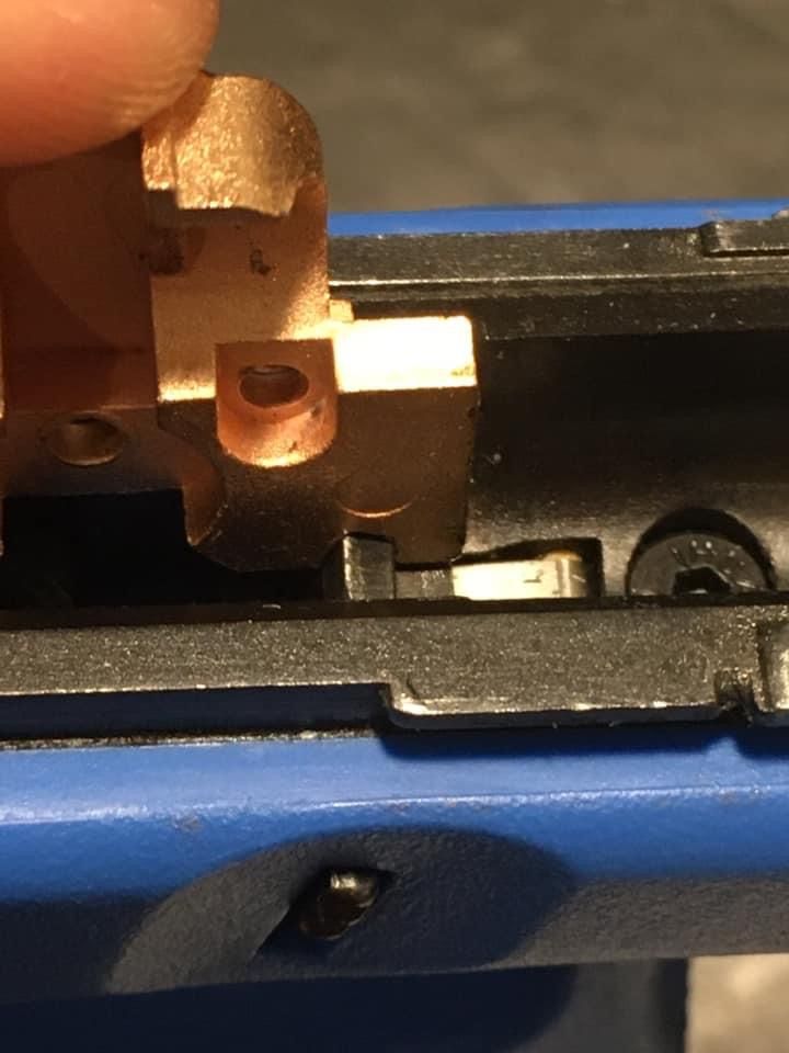

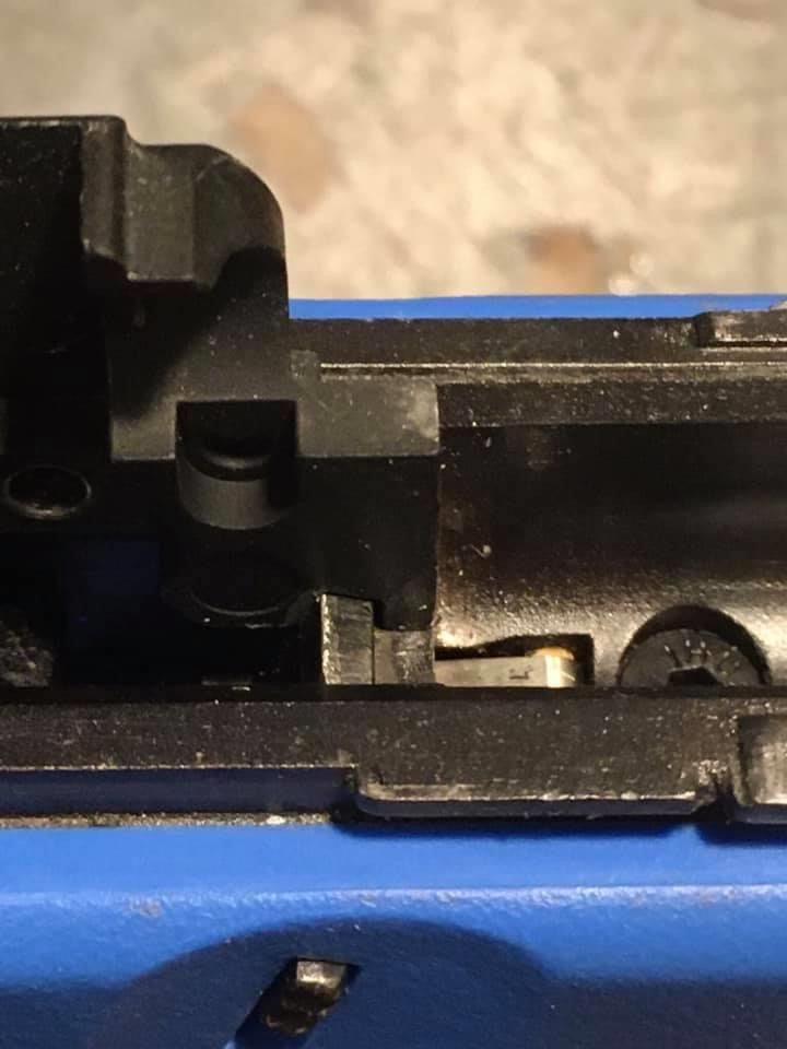

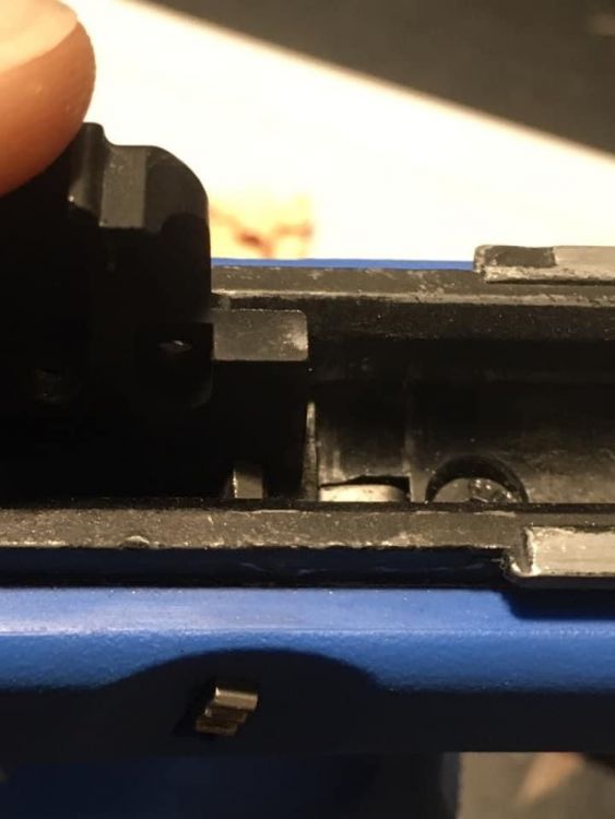

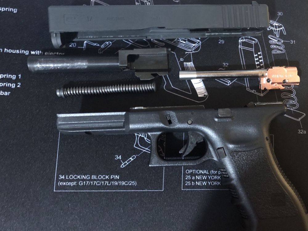

Also, the ML hop unit isn’t TM spec, it’s WE spec, so the g7n won’t be shooting as well as it could. You’d be better off using the ML hop unit internals and the original TM unit, or a CNC Guarder one.
If it’s your first TM to Guarder build, I’d be willing to bet it isn’t cycling particularly Well or efficiently unless you’ve tailored the rails to the slide. Also, you haven’t mentioned the required spring changes to the recoil and hammer either, I’m assuming you’ve set them up correctly for the weight of the new slide?

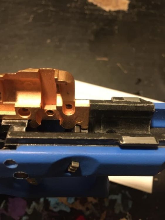

These are William Hicks hop-unit pics from FB, In this order:
TM in TM chassis
ML in TM chassis
TM in WE chassis
ML in TM chassis
No, not my 1st TM to Guarder and got the slide moving like glass on the chassis. Sanded both rails and slots on the slide up to 3000, sits and slides lovely, cycles flawlessly. Done a couple of full 226’s and a 1911 in the past so learned the hard way ?
150% recoil as stated, as a very recent G17 (shipped with G4 ambidextrous mag) I was under the impression the hammer spring was adequate, and have found it to be so whilst using propane.
I’ll have a look at the hop unit and see about moving things about, seems to be functioning but if it’ll perform better in the TM body, it’s certainly worth a shout.
Unfortunately Guarder frames in the U.K. are rocking horse ? right now, and nothing is leaving China for a while according to most of the retailers I use.
Thanks for the advice, looks like I’ll be keeping it then and having a play with the hop tomorrow.
