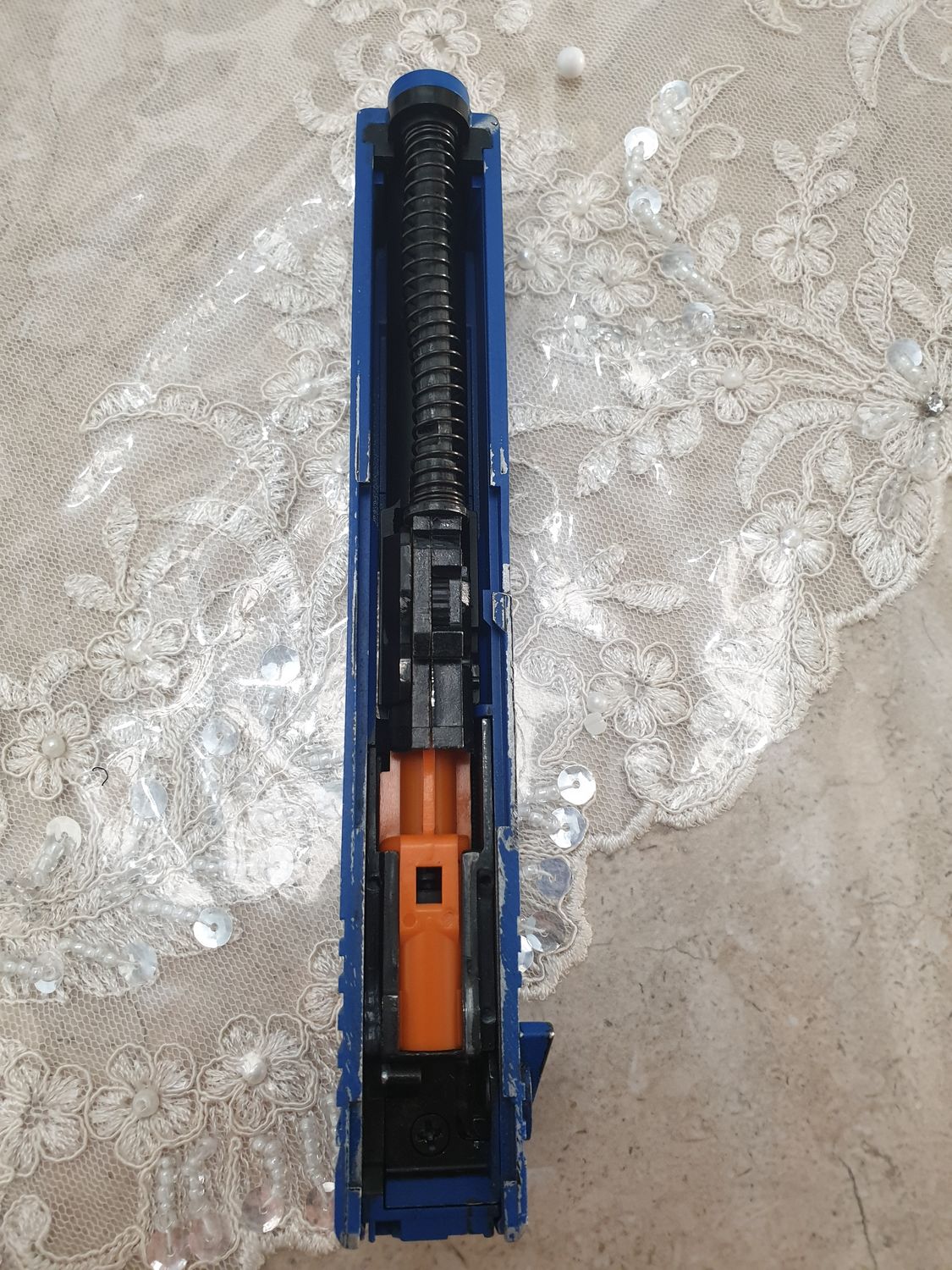

There is no issue with the gas since it all of a sudden stopped working. I have filled the mag and when I cock the weapon it does carry the BB to the chamber.
If it helps I done "maintenance" about 15 minutes before. After maintaining the weapon it stopped working. All I done was clean with wet wipes and just use toilet paper to dry it. I will attach pictures of what I cleaned and any other pictures you guys want.
With the first picture, I didn't take the parts apart  I just cleaned with wet wipes as far as I could get.

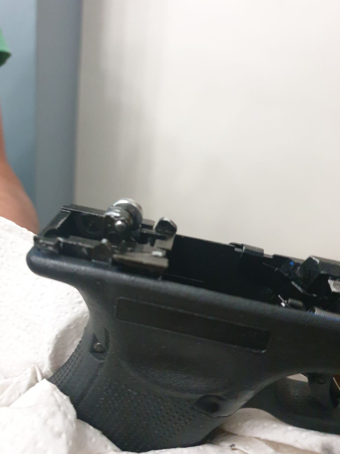

With the slide off try and get the hammer up , when pulling the trigger and pushing the tab in the hammer pack till it should catch and release the hammer if it does not you might have jammed it down , just a case of flat head and helping it up a little

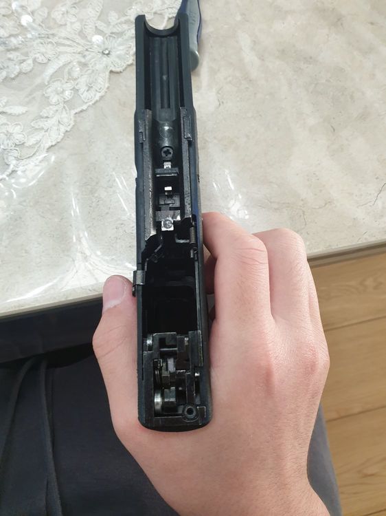

Second reason, It’s a Raven and they are very fragile. I can see there is a screw missing from the bottom left of the hammer assembly (in your picture), has it fallen into the hammer assembly?
No I removed the screw, if the part is broken do you suggest investing in another weapon?

My father just and I just forced the hammer up with a flat head. We put the slide back on but still the same. Once we force the hammer up what do you suggest us doing?
There is a small tilt sear top right in your photo, that is what releases the hammer, you just press gently on it

Guys just to confirm is the hammer in the bottom left of my gun that Silver thingy with the black thingy to the side of it?
