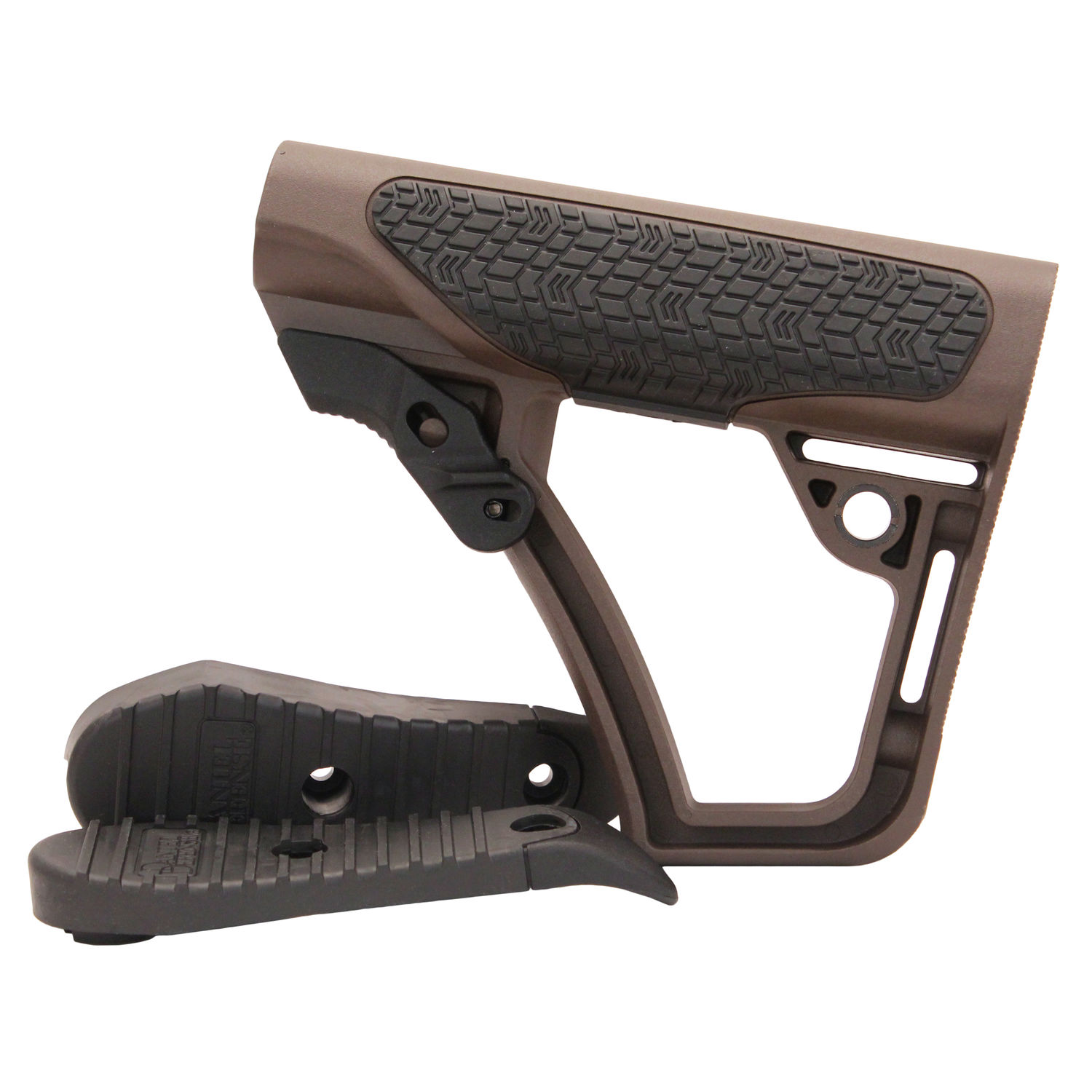

I can’t work out if I love or hate these stocks, and for that price I’d certainly have to land on love!
