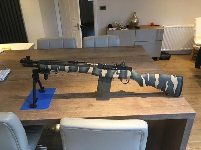

Stevo4345 Posted March 30, 2020 Author Posted March 30, 2020 Update on progress, the tiger stripe paint job came out ok for a first try, then onto the gearbox. Put some new bushings in from @ak2m4, just the job. Re-shimmed the gears, had to modify my new tappet plate as it had a tab on one side that didn't fit, no worries. Got it back together and it works, kind of! Won't fire in semi, which is a bit of a head scratcher as the fire selector cam isn't fitted (came as a dmr) so it should only shoot in semi. Thing is I put the stock spring in just to test it but it's a hi-torque motor, might it be running too fast for the selector to action, 16-1 gears installed? Will also need to check the cut off lever and trigger trolley as seeing the wear and tear on the rest of it one or the other, or both, may be past it. So it still needs fettling but making progress.
