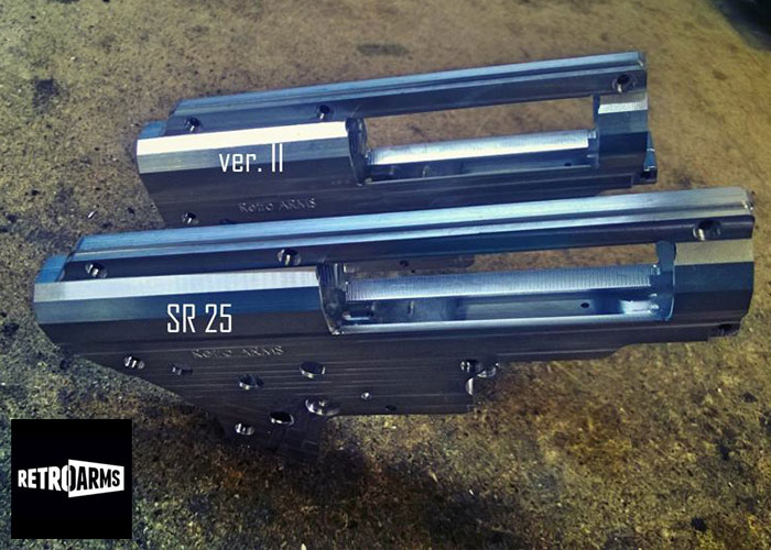

In terms of the gearbox, specs are showing towards receivers hosting Version 2 Extended gearboxes. Will these still accept standard motors and pinion gears?
Extended gearboxes run some slightly modified parts.
More teeth on the sector gear (the gear that pulls the piston).
More teeth on the piston and it's longer with more travel.
Longer cylinder.
The gears are normal dimensions and a standard motor will drive them.
The SA80 L85 normally runs one of these. Not all Sr25's do you have to check the specs.
Because of the increased volume in the cylinder you run into a few features of those boxes:
They can run longer inner barrels.
They get different Joule outputs for the springs.
Guns that run them are designed to have the longer cylinder. You can't drop an extended gearbox into a standard gun.
Often V2.5 boxes are split, So the upper cylinder part of the gearbox can be removed from the lower gears part of the gearbox. ICS and G&G Sa80's do this I belive.

Okay then, TaiwanGun sell an A&K SR25 base for £200 which looks like a great place to start.
It has the extended V2 gearbox, so off the top of my head I will need to install
- MOSFET and deans connectors
- new Hop chamber and bucking
- inner barrel
- gears
- piston
- tappet plate
- cylinder
- cylinder head
- spring
- motor (+ better pinion)
Also need to source a pistol grip, buffer tube and stock.
What did you mean by bevel/spur?
Also, would a new trigger system be worthwhile installing?
- inner barrel
- gears - well maybe a SHS 16:1 bevel/spur but not absolute must
- piston - yeah a steel rack is wise, there are a few SHS 19 tooths
you still want a poly/plastic piston than alloy one
old yellow, newer blue type or Pete seems to offer a white piston will metal rack
- tappet plate - nope, but look out for a spare one is my advice
- cylinder - should be a full cylinder anyway, test compression and replace only if needed
- cylinder head - yeah probably, can get a long spout one as nozzle is longer than M4
- spring - need to check your site very carefully most sites for DMR's are 425 - maybe 450fps
Bolt action they allow 500fps but not DMR's

nozzle - should be "about" 24.7mm - a 24.5mm G36 might be too short
Some use an AUG nozzle - think it will be a case of looking to buy a couple and compare closely before testing
Hop/barrel - stuff can be sorted later
You have the issue of locking it to semi only - selector plate mod or fancy mosfet
You decide what way you approach this - it will still fire on auto out of box
So you need to factor in how to lock it
a small additional switch hidden in stock to fire full auto is optional if it locks up in dead zone
(unlikely but will save you agro if it happens on field)

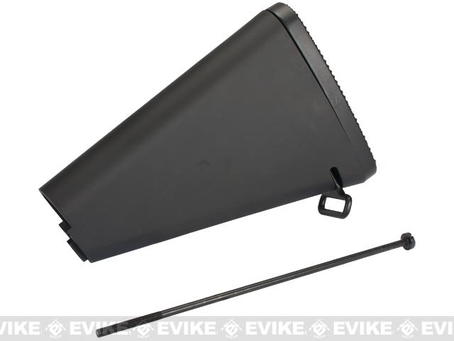

A full size fixed stock on a DMR - the proper hollow one is nice
chuck a car battery in there, loads of room for mars bar lunch and any size mosfet etc....
make sure you get the plastic ring though....
Image result for m4 fixed stock ring
THAT can be a bastid to source or make up as "some" full/stubby stocks don't all come with it
included above....
Related image
NOT INCLUDED in the above stubby stock
been caught out myself buying stubby stocks - bastids
Avoid an ICS full size stock coz the bolt is shorter as ICS screw into an adapter and inch before spring guide
plus isn't as hollow as other full size stocks
avoid the adjustable one too as the battery doesn't quite just plop in...
http://www.taiwangun.com/en/stocks-and-accesories/adjustable-fixed-stock-for-sr-25-ar-15-m4-black-cyma
if you look at all the pictures - yeah it is a bit of a wank to put the battery in and small space
compared to the suitcase a cheapo full fixed stock offers
Yeah fixed stocks - you can get stung buying certain ones I found
