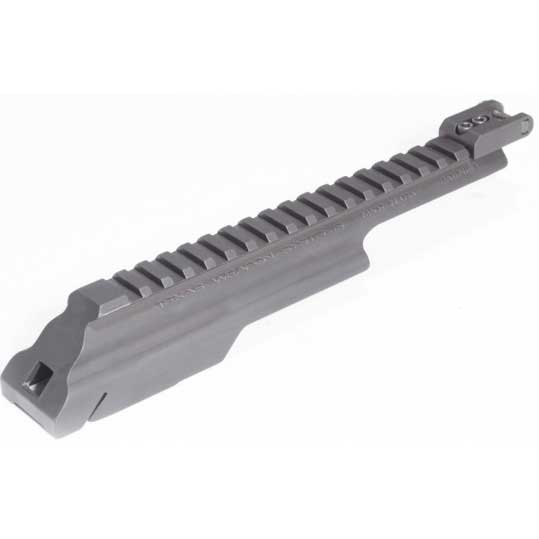

  • The left side of the gun doesn't have a dimple (see here), so I don't think I can use this type of rail mount. Does anyone have any experience with either of these types of rail mount? 1 2

so you should have the screws underneath to mount a rail:
kalashnikov-ak-scout-rail-scope-mount-2_
now you "might" need to file a tiny bit off off the top left of the mount
it can on some models just slightly catch/foul but it might be OK
The other types of rail mount might need a bit more careful work/modding
or dust cover with rail is a bit more and not always easy/cheap to source
others have drill & tapped a rail onto existing dust cover
but for ease of simplicity many might just use the bolt on rail
(if the screws are underneath - which they seem to be)
