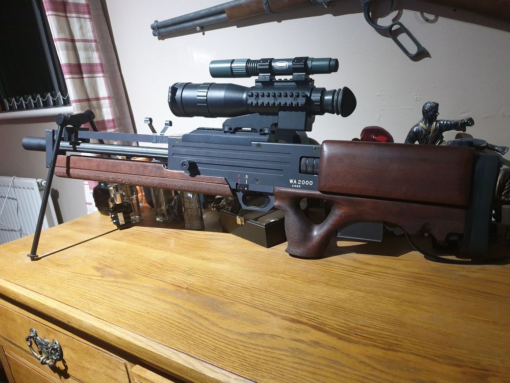

Supporters Shizbazki Posted April 24, 2018 Supporters Posted April 24, 2018 TL:DR is a 45 degree sear ok for M150 spring (500FPS)? Also name me a good bucking? So I have recently acquired an ARES WA2000 and while a lovely looking rifle its performance is a bit on the lacking side. Its FPS is about 380FPs on .20g BBs and whilst i know that FPS isnt the end all and be all i would like to up this to most of my sites max FPSs. As for range i cannot tell what its like but looking at the crap bucking put in their by ARES its probably going to be pants at best, i plane to change this anyways. So for those that dont know i have done so of my own research into this gun and found the following was compatible with VSR parts: Inner barrel measured to be 500mm in length, needs to be a bridged window barrel. Hop up bucking Cylinder head Cylinder Piston Piston Spring Spring guide Now i must point out that the trigger is a 45degree trigger, i read in various forums that the 45 degree trigger cannot be exchanged for a 90 degree one so i am stuck with 45 degree and it looks like the Ares one is made of the usual airosft pot metal zinc diecast material when i took it apart the last time. So my plan is to buy a full upgrade set Cylinder head, Cylinder, Piston, Piston Spring, M150 Spring and Spring guide. I am hoping the 45 degree sear can be swapped with a TM compatible steel one for great reliability but will it be ok for an M150 spring? Also what would you recommend as a good bucking, i have heard Maple leaf being thrown around amongst other brands.

Supporters Shizbazki Posted October 6, 2019 Author Supporters Posted October 6, 2019 Oh Hi I totally forgot i posted this up haha. So the hop up chamber had to stay the same as its is unique to the Ares WA2000. As for the other parts i upgrade them with the following items: Hop up bucking - I tried both a PDI (https://www.fire-support.co.uk/product/pdi-vsr-10-hop-up-rubber-w-hold-type) and LayLax (https://www.fire-support.co.uk/product/laylaxnineball-hop-rubber-for-marui-vsrl96-and-marui-pistols-purple) one. After some testing i think the PDI one was better but marginally. The Cylinder head, Cylinder, Piston and Spring guide I got was from this set https://www.fire-support.co.uk/product/pdi-precision-palsonite-cylinder-set-hd-for-marui-vsr-10 I must say very well machined and precision made. The Spring i used was this: https://www.fire-support.co.uk/product/pdi-520fps-spring-for-marui-vsr-10-13mm-outer-diameter though i grinded it shorter to bring it down under 500fps on .20g BBs As for sears, i had to keep the trigger mechanism the same as its propriety, i would have preferred a 90 (or zero) degree trigger but that's just not possible in this rifle. I had to keep it 45 degree trigger sear and so upgradded the sear to a steel hardened, which was this one: https://www.fire-support.co.uk/product/pdi-vsr-10--l96-piston-sear-2nd-sear I took it out to skirmish once to test it only, to be honest i didn't get very good test results as it was windy, the light was poor and was forced to use bio BBs and it was hard to see there trajectory. For now i have put this project rifle to bed and plan to probably get or make a 3d printed plunger so that the BBs dont get too scratched up. I also plan on using the Novritch .40BBs some day as they are a) better quality that the Bio BBs i was using and since they are white, should be easy to see on a decent day.
