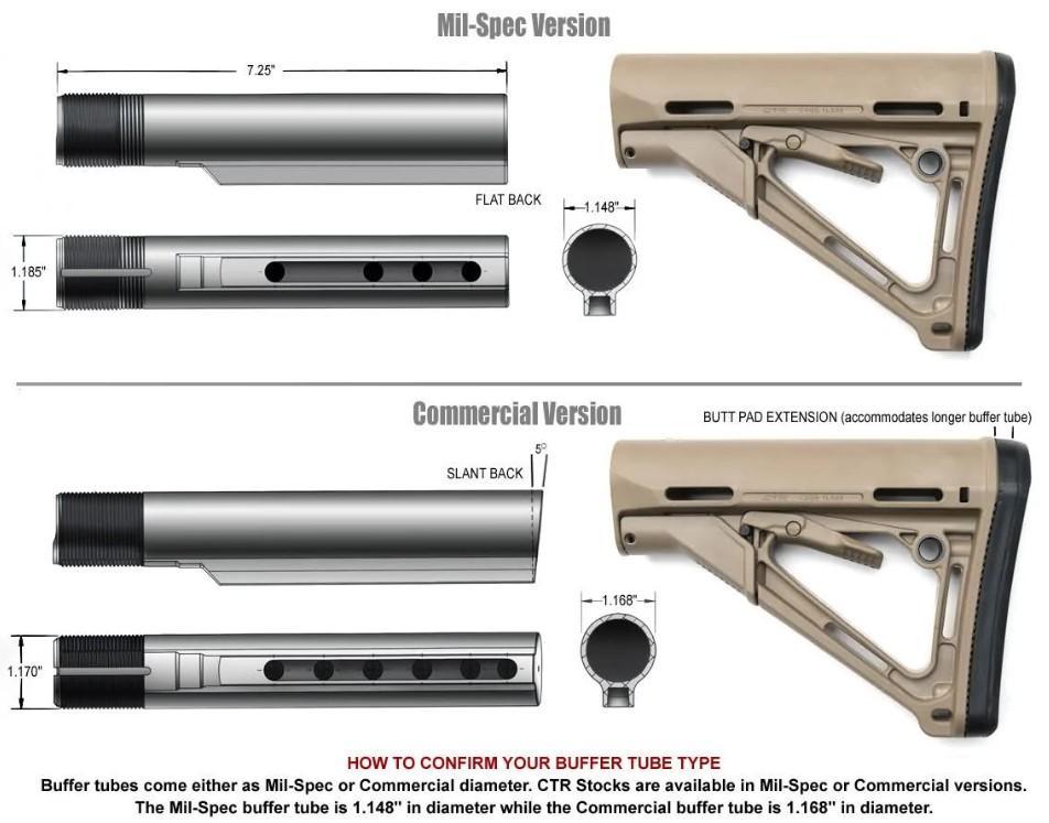

davidf Posted February 26 Share Posted February 26 Hi all, Do I need a Commercial Spec MOE Stock or a Mil-Spec MOE Stock for this buffer tube? 5KU Picatinny 5 Position Buffer Tube with Adapter Thanks Link to comment Share on other sites More sharing options...
Chev Chelios Posted February 26 Share Posted February 26 MILSPEC tube. Commercial are slightly wider. Buffer tubes are not expensive and it will come off the mount if you have compatibility issues. Link to comment Share on other sites More sharing options...
davidf Posted February 26 Author Share Posted February 26 2 minutes ago, Chev Chelios said: MILSPEC tube. Commercial are slightly wider. Buffer tubes are not expensive and it will come off the mount if you have compatibility issues. Thanks mate. I will ammend my order then. I did measure it (not with calipers) and it seemed it was closer to 1.17inch But I will trust you over that Chev Chelios 1 Link to comment Share on other sites More sharing options...
Chev Chelios Posted February 26 Share Posted February 26 4 hours ago, davidf said: Thanks mate. I will ammend my order then. I did measure it (not with calipers) and it seemed it was closer to 1.17inch But I will trust you over that If you already have it, its easy to tell by the flat or slant back. TheFull9 and Impulse 2 Link to comment Share on other sites More sharing options...
