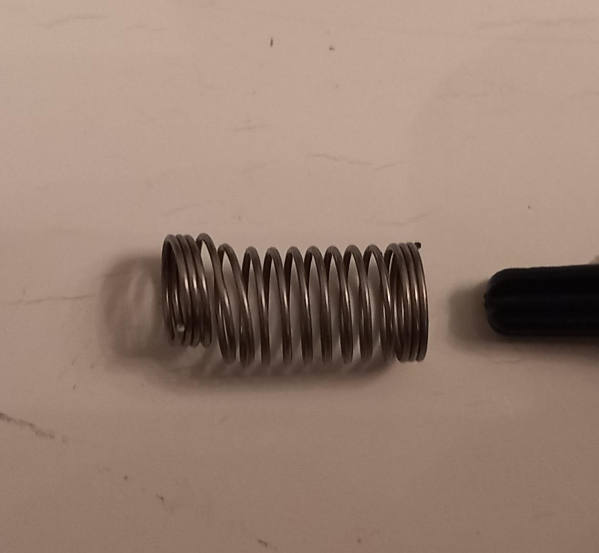

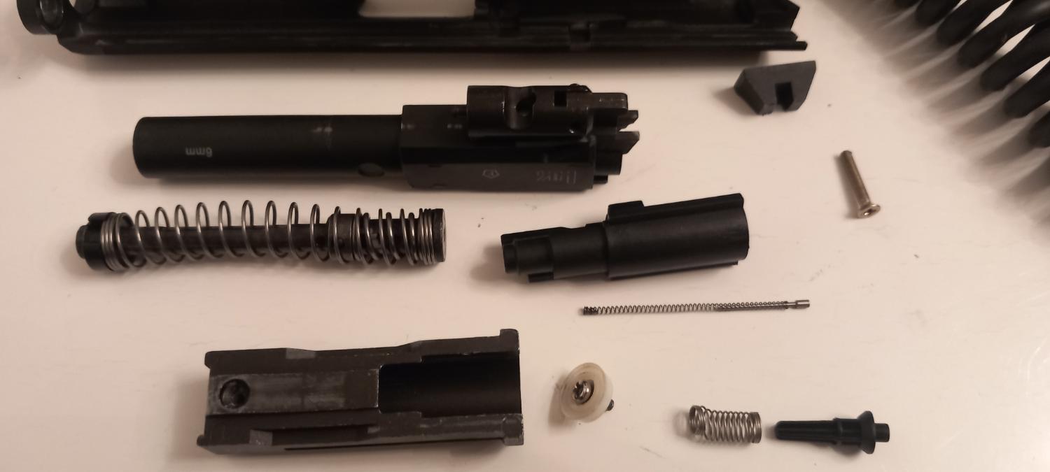

Barry Sayer Posted January 4 Share Posted January 4 I've purchased a new mag for my h&k usp, it's dumping the full co2 bulb in one go after the first shot. The original mag is the same, the seals are all good, plus I lube them regular. Any thoughts please ๐ค Ta Link to comment Share on other sites More sharing options...
JimFromHorsham Posted January 4 Share Posted January 4 Sounds like the valve knocker in the pistol or magazine valve isnโt returning .ย Barry Sayer 1 Link to comment Share on other sites More sharing options...

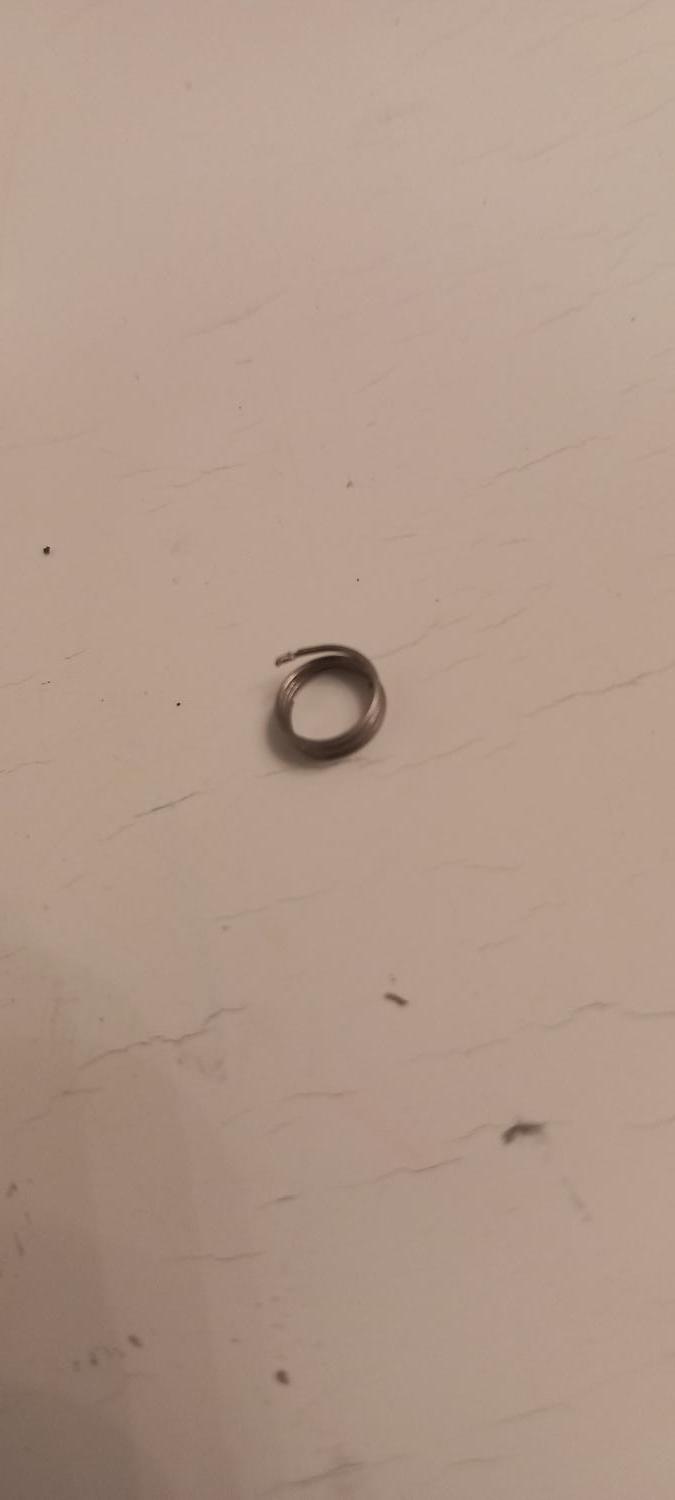

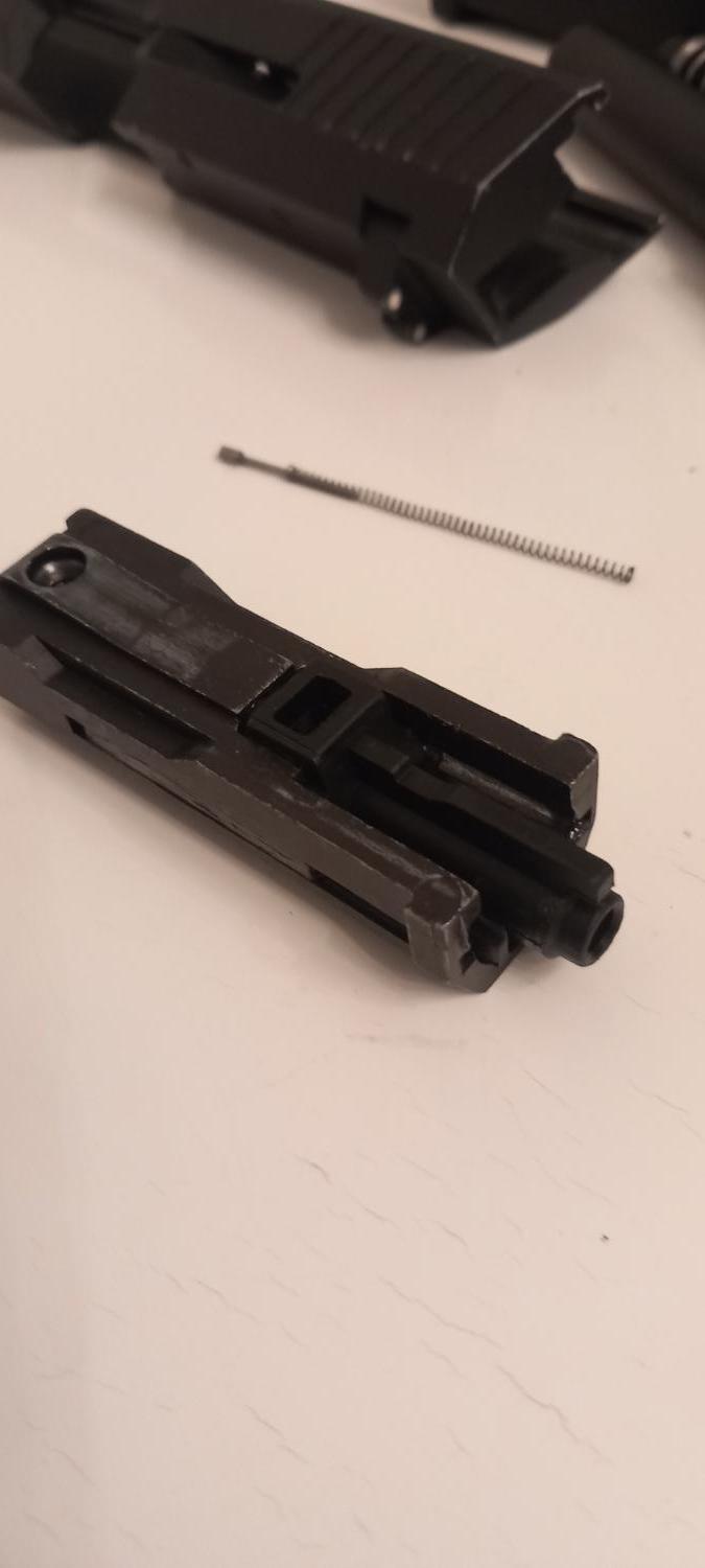

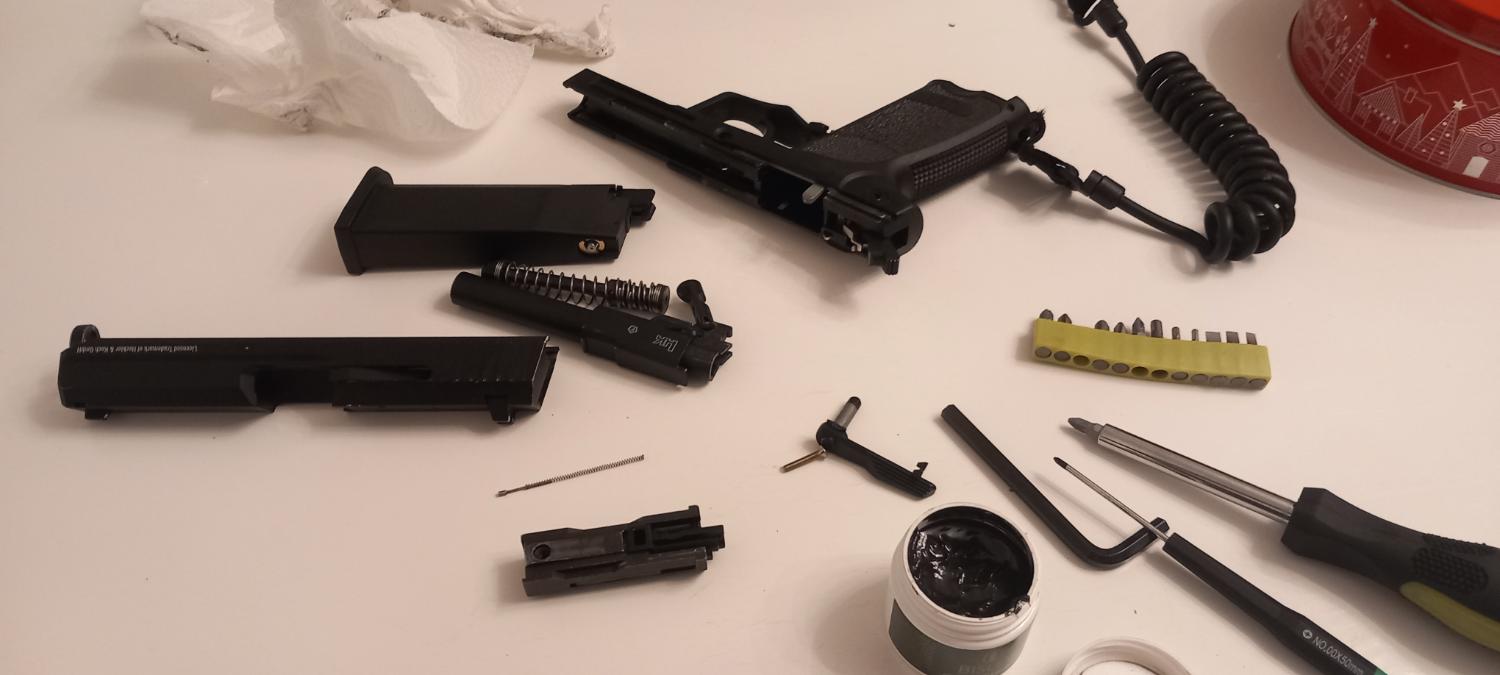

Barry Sayer Posted January 4 Author Share Posted January 4 1 hour ago, JimFromHorsham said: Sounds like the valve knocker in the pistol or magazine valve isnโt returning .ย Definitely pistol, not the magazine. A bent spring found on further investigation could possibly be the problem....will cut it back and temporarily stretch to correct *ish length until I source a new one. Tested and worked OK. Some hop adjustment was required....it was a mile out dropping about 8 inches at 6yards! Strange how a strip down has thrown it out that much, is that norm๐ค Link to comment Share on other sites More sharing options...

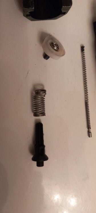

Barry Sayer Posted January 4 Author Share Posted January 4 I think it's called the nozzle return spring that was the problem with mine. How the hell has it deformed I'll never know, its a deep internal part, so its a mystery. Looking at the exploded parts diagram it's part S07. It's a 15mm spring so now is the trauma of trying to find one ๐ย Link to comment Share on other sites More sharing options...
Anonymoose Posted January 4 Share Posted January 4 If you need one quickly and we can still find a replacement i can take the one out my 4.5mm USP. (Assuming it's the same.) Enid_Puceflange 1 Link to comment Share on other sites More sharing options...
Barry Sayer Posted January 4 Author Share Posted January 4 43 minutes ago, Anonymoose said: If you need one quickly and we can still find a replacement i can take the one out my 4.5mm USP. (Assuming it's the same.) Thanks for offering, I'm in no rush for one. I've got it working with the botch chop down and re stretch to fit ๐ช ๐...crude but it worked, fired a couple of mags through it and was spot on , no leaking ๐ Still puzzles me how its deformed ๐ค Anonymoose 1 Link to comment Share on other sites More sharing options...
