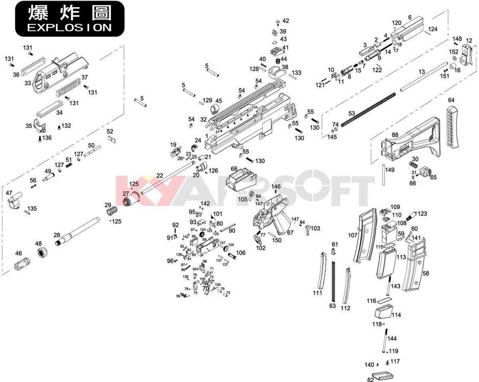

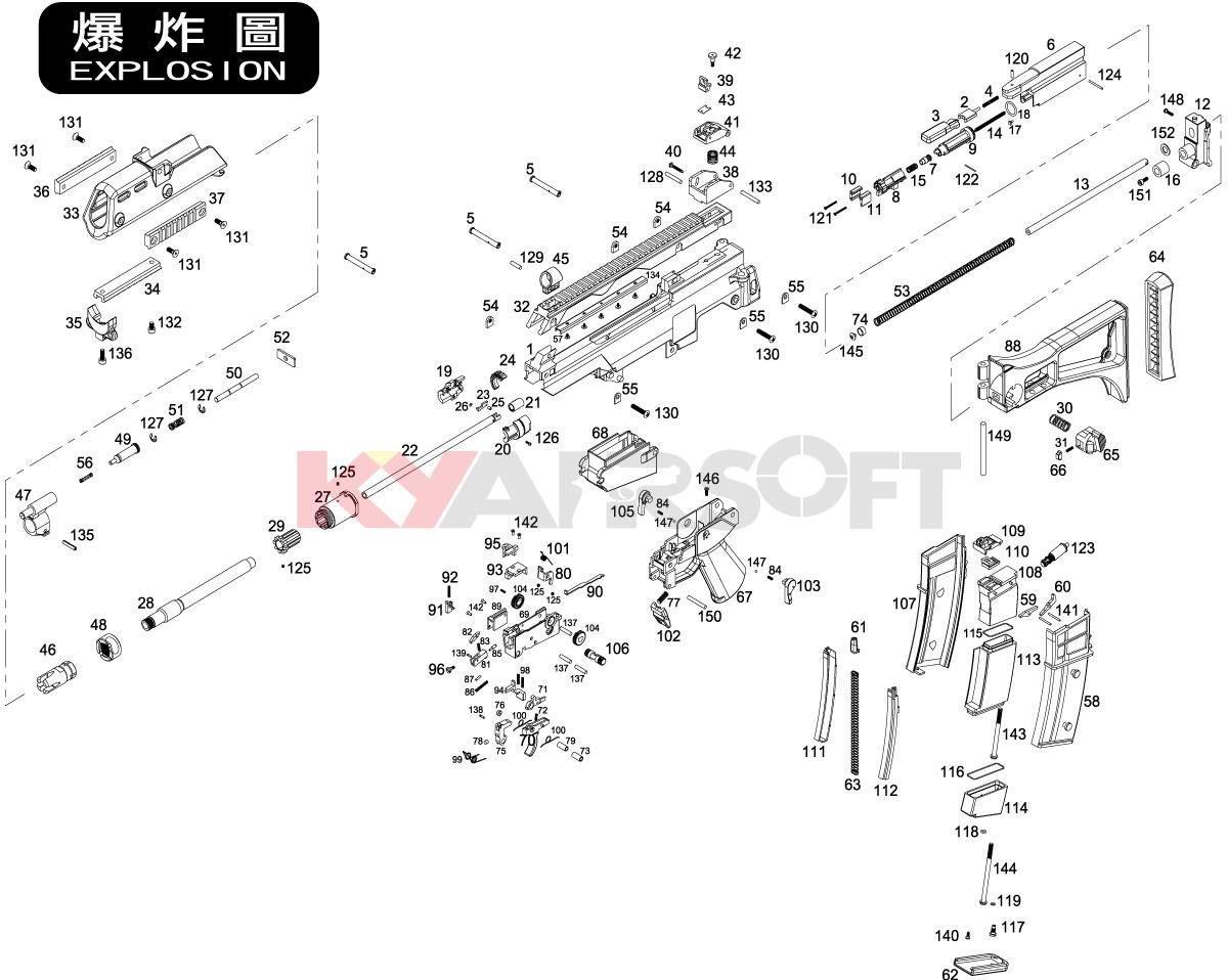

Nick G Posted December 26, 2024 Posted December 26, 2024 I believe the AA version is pretty much a clone of the WE G36. If that's the case there is (from memory) a spring and ball detent fitted to each selector lever. The selectors can be removed easily enough , well worth checking to see if stronger springs would help. Parts breakdown of the WE below. Austeyr 1
sjhirst Posted December 28, 2024 Posted December 28, 2024 It's not the best selector in the world! I took the lower off mine, undid the inside tiny grub screws (146 on diagram) and stretched the springs a little bit. That improved it a tad bit. Nick G 1
