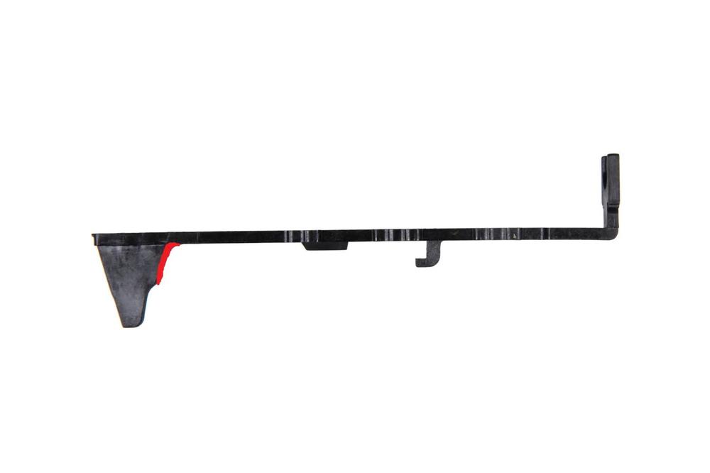

FPS Softair Carbon Fibre Reinforced Tappet Plate for Version 2 Gearboxes (Trimmed by 6mm)

Could it possible be PME, or maybe I've trimmed the tappet plate too short or some other weird tappet timing issue?

If you are losing fps on auto its, to be expected to a degree, but you might be pulling the tappet plate back early... you'd need to look at how it cycled out of the gun manually

What would be the best way of slowing down the pulling back of the tappet plate? Maybe I could try and run it without the delayer? Or maybe I can shave the tappet plate down slightly like in the pic attached? Guessing this will cause issues with the nozzle and feeding though.
